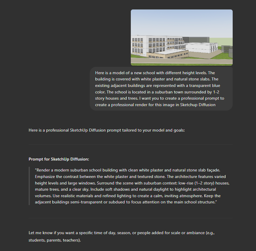

I’ve been testing different methods to get high-quality renders at the very beginning of a project If you’re using SketchUp + SU Diffusion + ChatGPT, here’s a workflow that’s been working for me:
1. Export your SketchUp view
Take a clean screenshot or export of your scene then upload it to ChatGPT
2. Use ChatGPT to generate a professional prompt for SU Diffusion
Instead of manually writing your own prompt, just ask ChatGPT to do it for you — it usually gives you a very clean, optimized prompt tailored to your scene’s style and goal.
3. Paste the prompt into SU Diffusion
Drop that prompt into SU Diffusion and generate. Pick the one that best captures your vision.
4. Upload that render back into ChatGPT
You can describe what you’d like to improve — Add people, blurred cars, corrected lighting, or more atmosphere. ChatGPT will help adjust the prompt to refine the render further.
  1. I often rewrite the prompt if the rendering is too distorted, or I can add other tweaks
  1. If you have time, import the final renders from both ChatGPT and SU Diffusion, then blend them in Photoshop for even more control and polish.
  • PS: You can add the rendered image from Chat GPT in SU Diffusion to ‘‘Add a reference image’’ - it makes it even more realistic. Try to Experiment .. :)*
  • PS2: Impressed by SU Diffusion (but more so by Chat GPT). I still haven’t figured out how to properly use artifacts and regenerate parts (I assume these options will be dedicated more to SU Ipad)

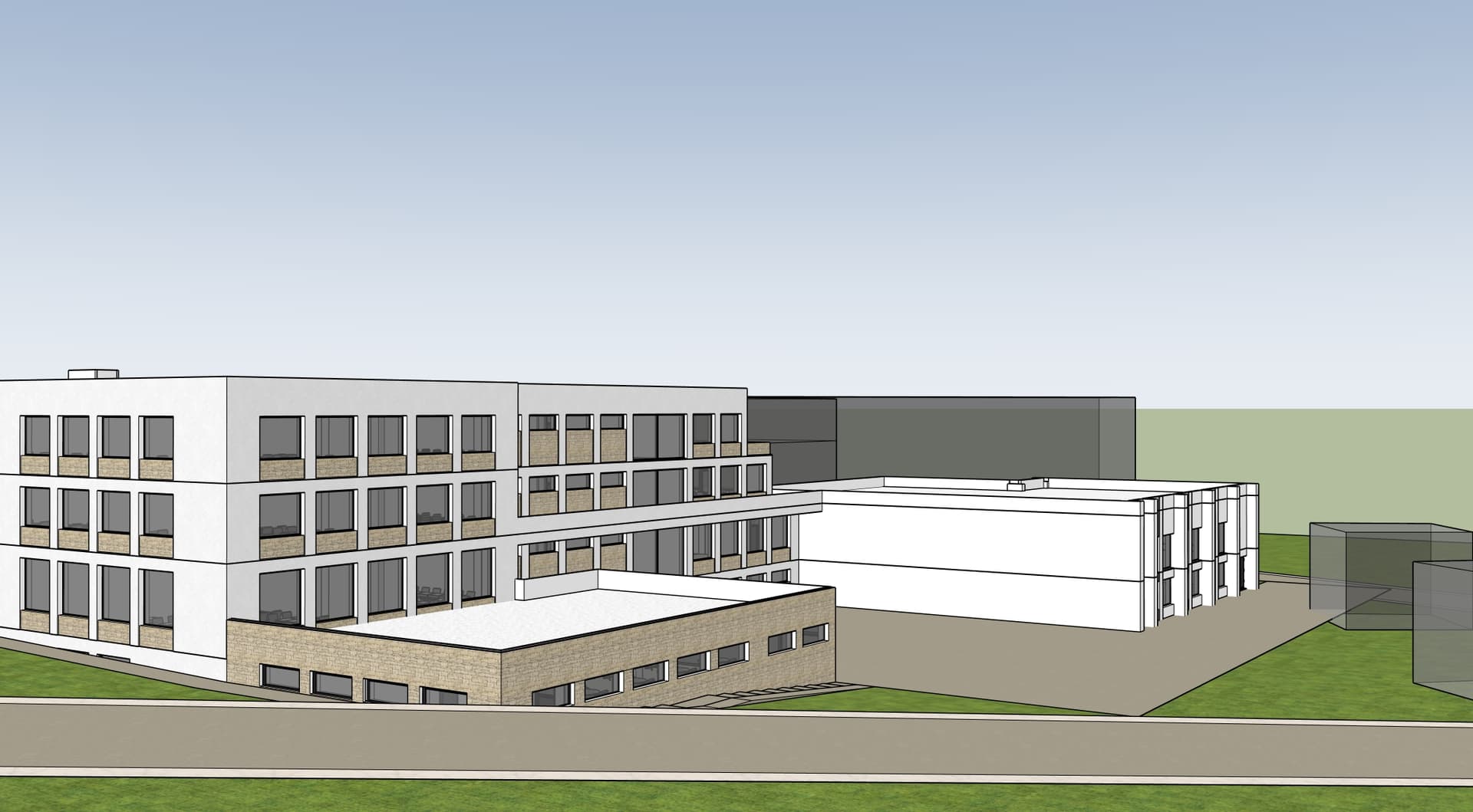

Continuation of the post above: A comparison between ChatGPT, Google Gemini, Grok and Copilot.
Same render – same prompt.

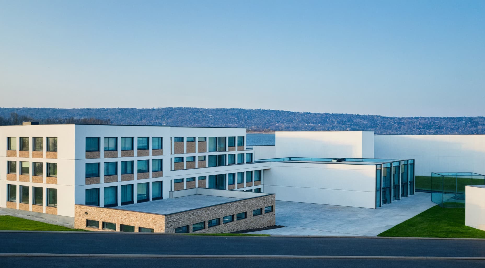

The original SketchUp Diffusion Render
The prompt:
Respect model geometry and preserve material/ colors of the building Add realistic trees around this render, spread some pupils and a few adults walking on the concrete pavement in front of the school. And a car on the asphalt in the foreground of the image. Make the car and the walking people blurred.

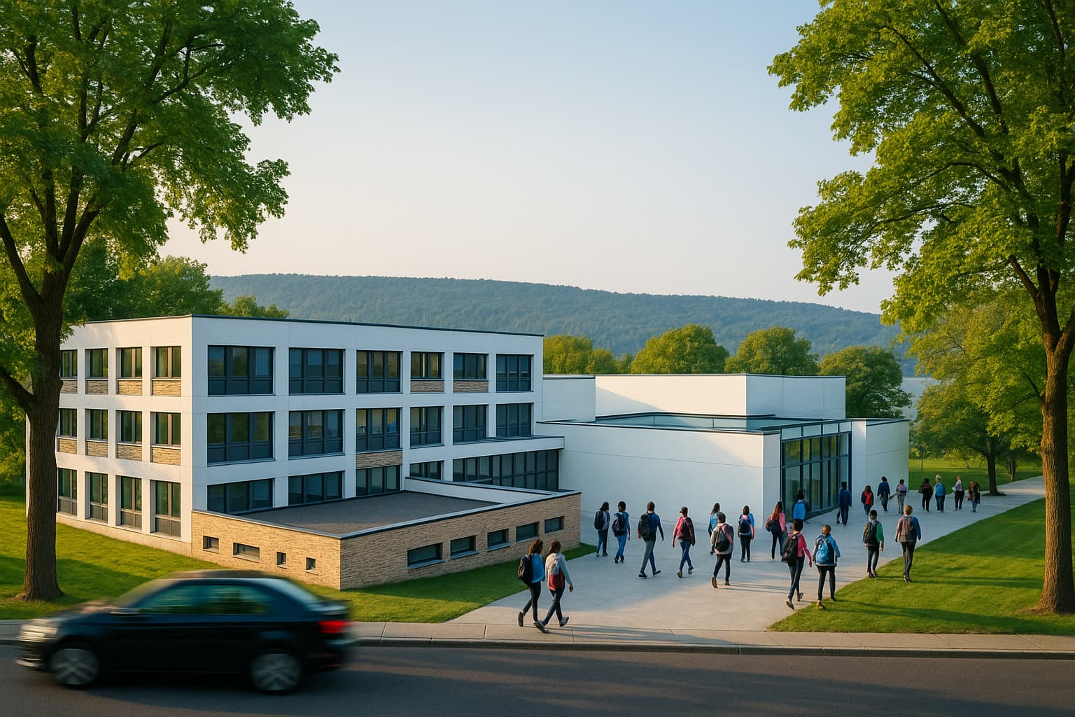

Chat GPT

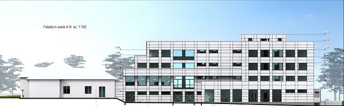

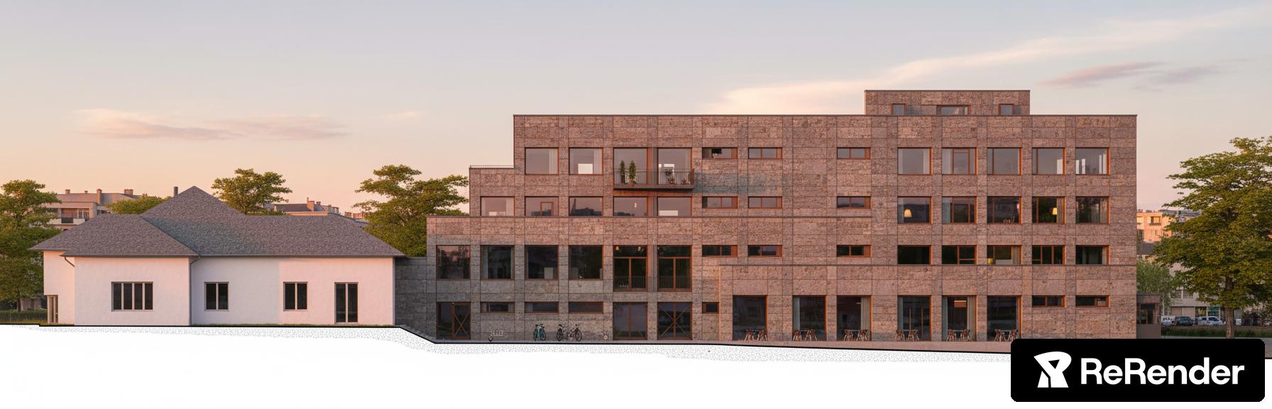

It took me some time to find an AI rendering engine for elevations. I tried many, including SU Diffusion. None of them handle it well—they don’t understand elevations and end up generating perspectives instead of parallel projections. Only ReRenderai. com (below is an SU/ReRenderAi example) seemed the closest to reality.
Has anyone tried rendering realistic elevations/ paralel projections with any AI renderers, since ReRenderAI is quite expensive?
