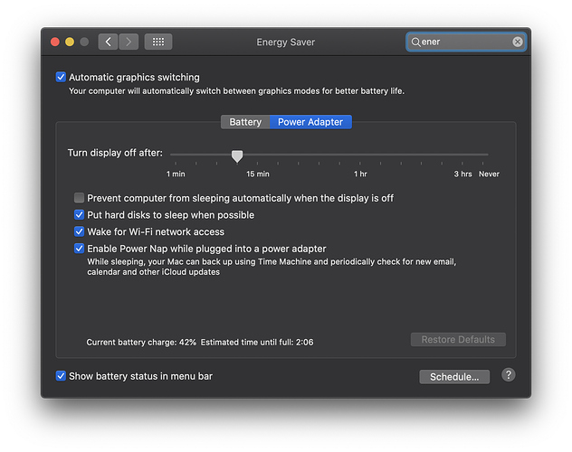

  1. Battery
  2. See pic
  3. Installing desktop just now and I’ll see how that goes

what’s your other graphics card?
the Automatic graphics switching will cause the symptoms you original posted…
both chrome and SU desktop will perform best with that disabled…
john
It sounds to me as if your computer isn’t really set up for running graphics intensive applications while on battery power. As John points out, you have Automatic graphics switching enabled and that can create problems for applications that depend heavily on the graphics.
john
It’s high spec MacBook Pro. Not aware of any other graphics card.
I’ve switched off automatic switching to see if that helps.

Automatic graphics switching implies it has something to switch to…
with it turned off, and with SU running, a second card should show in the About This Mac >> System report >> Graphics/Displays section…
