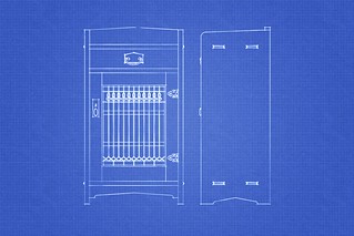

Since you are using LayOut, you must be using SketchUp Pro despite your profile indicating you are using SketchUp Free. With SketchUp Pro there’s Style Builder which makes it easy to create your own sketchy edge styles.
I’ve made quite a number of my own sketchy edge styles. Examples:
