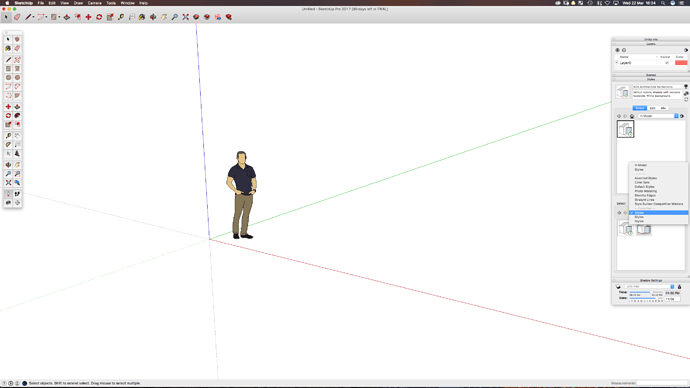

I managed to finally create a copy with the correct name, after three more attempts. On the last attempt I pressed Enter before selecting create new Style.
Now, when I drag it to the ‘Styles’ folder I created, (of which there are three copies for some reason???), it then defaulted back to the “blah blah1” name, in that folder.

Managed to figure out the Desired Library bit, it was showing thr wrong library, but why has it created 3 copies of MY Styles library when I pull down the list?

The style shows up three times in In Model because you’ve created three new styles.

The name shows up multiple times because you keep adding it into list. Select one of the
Styles folders fro the list, open the Details menu and choose Remove from Favorites. repeat until all the “Styles” libraries are gone.
I just want to make it clear to you that these are “Favorites” (ie, links) that are all 3 pointing at the same folder. Or, more specifically, each share the same URL, which would be invalid if you changed the name of the folder manually.
These “Favorite” links here and in other resource panels of SketchUp, are just like saving “Favorites” or “Bookmarks” in your browser to websites or folders (either local or network.)
