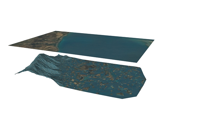

I’m trying to apply an aerial image to a terrain i’ve created in sandbox from contours.
when i try using the bucket tool it applies the image to each triangulation individually?
anyone have any ideas on how I can fix this?
thanks in advance
the file is too large to attach, but I’ve put it on dropboxhere: https://www.dropbox.com/sh/aimvhhv256atu33/AADgEsNDe96-a47lhDVmjz6Oa?dl=0
Change the upper texture to projected via right click>texture (make sure only the surface is selected, not the edges). Then select the bottom surface, resample the top and apply to the bottom.
brilliant thanks :slight_smile:
You had already done the hard work, getting everything to line up in the X,Y so it would project well. Very nice detailed terrain BTY, where did you get the contours?
Cheers, created it in Civil 3D then imported into Sketchup
