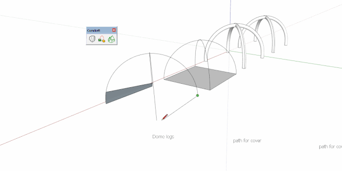

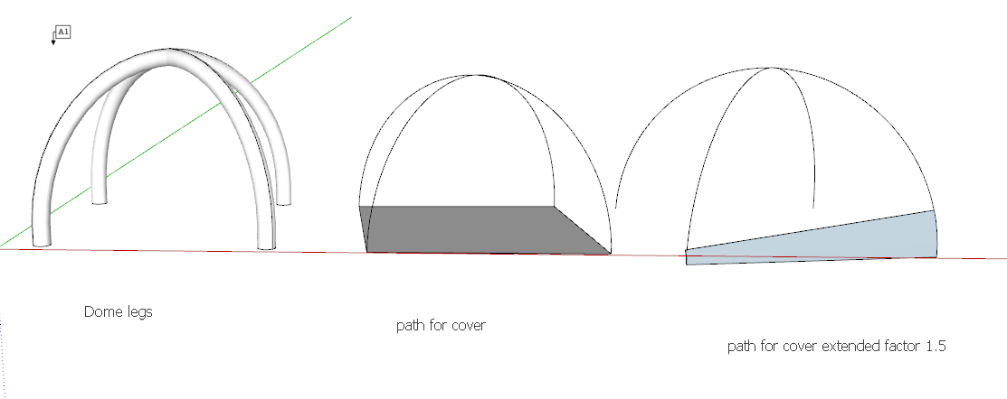

If that is the shape you want you just need to draw edges across from endpoint to endpoint and smooth it. Or draw one edge diagonal to make a face and use follow me with the square as the path.
Illustrating @Box’s suggestion:

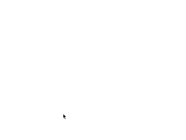

Here’s a quick, back from the pub, gif on the very basics of stitch, soften and array to create the shape. Even follow me is technically an extension.
Understanding how to build geometry will take you much further than knowing which extension you need to do that bit.
