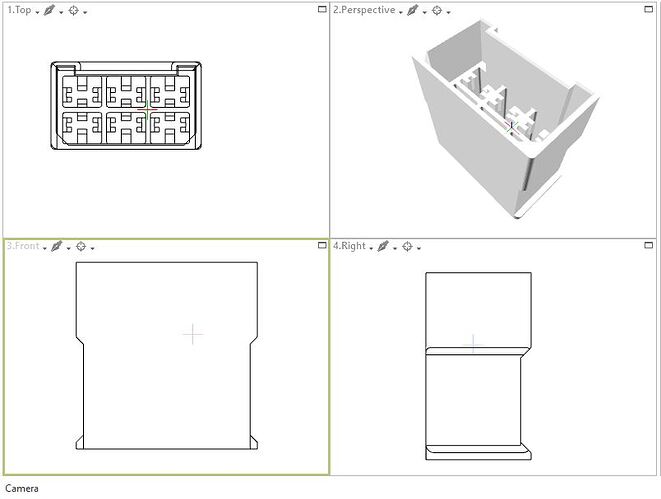

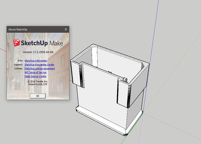

There a lot of posts about STLs not importing at all. Mine seem to import fine and quickly. But the model is all messed up, and it seems like its not really the same messed up each time I import it. I have tried every combo of import settings possible and different scales. I want to make this part of another part which is why I am trying to import it.

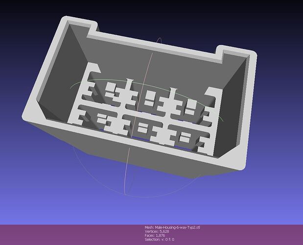

The file opens fine in my slicer.
Male-Housing-6-way-Typ2.stl (511.2 KB)

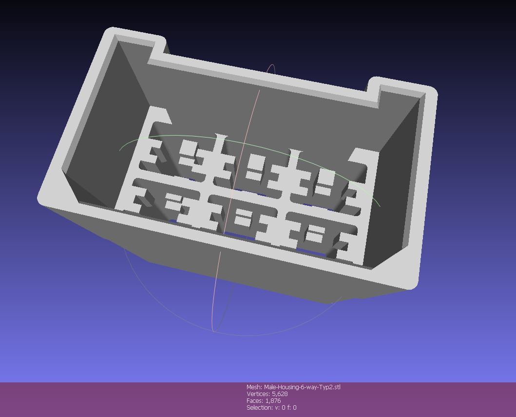

The .stl does import as a mess even with Import units set to Meters.

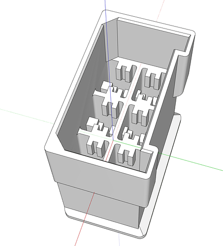

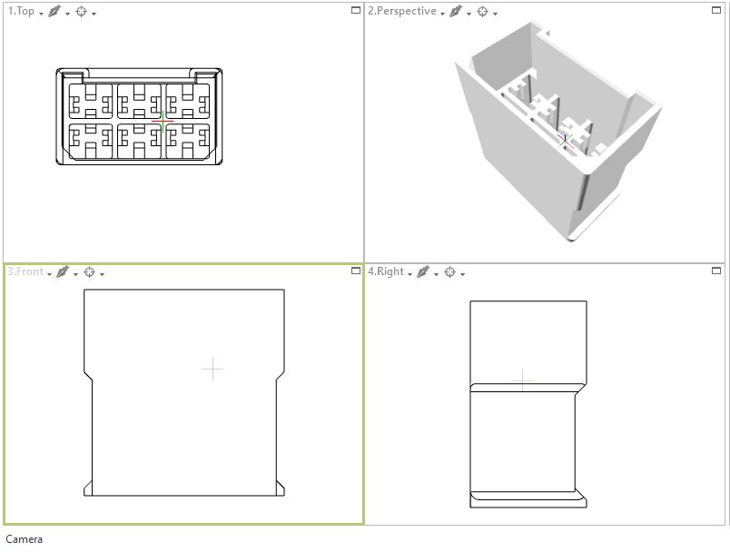

I opened it in FreeCAD and immediately exported it as a new .stl. That improved things greatly.
How are you using this thing in your model?

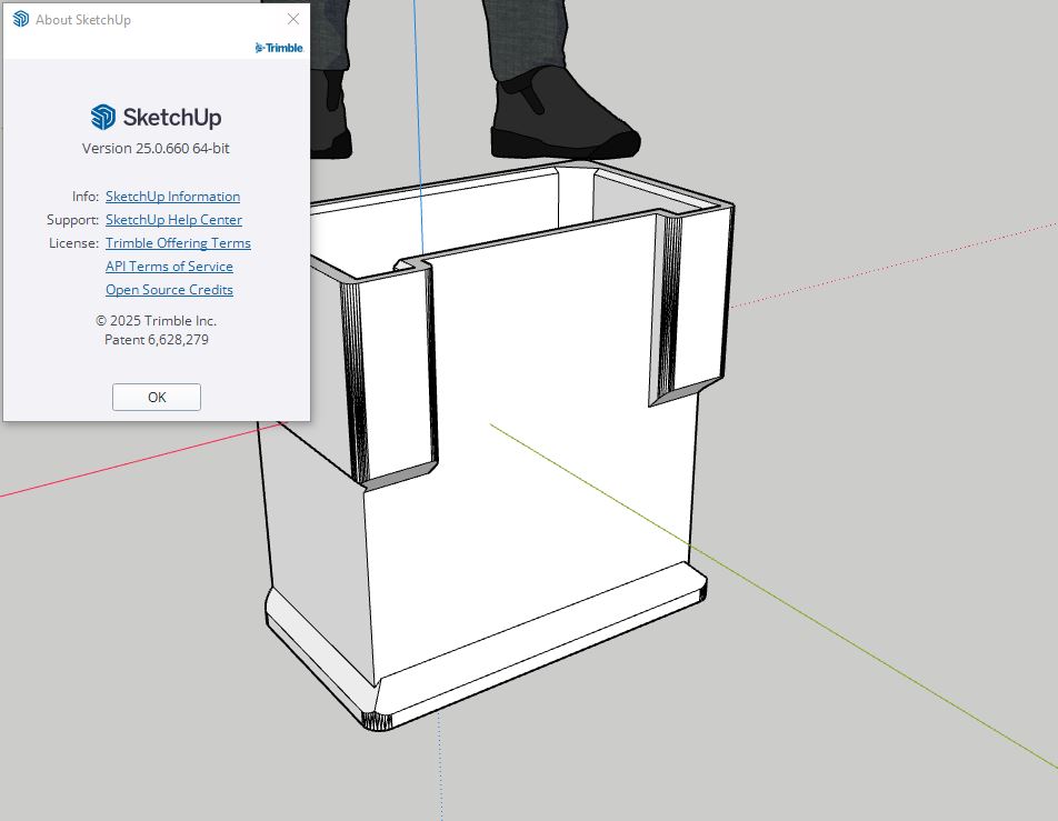

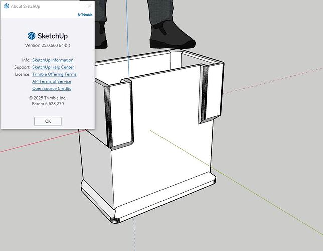

Yep, something very odd with the original .stl, same result for me. Imports messed up, but opens in cura fine and when exported from there imports happily into sketchup.

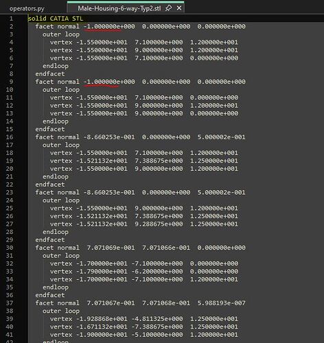

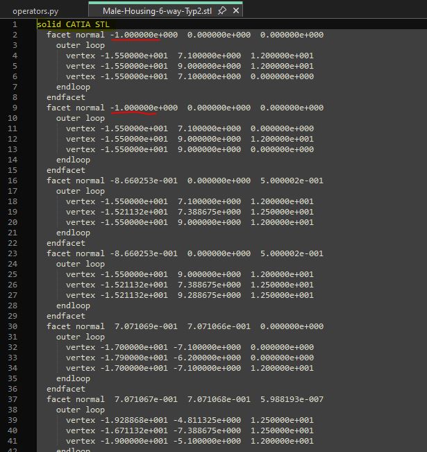

I wonder if it is related to the old scale -1/mirror problem that the built in stl exporter had/has. When the new inbuilt version was added it always failed to export mirrored objects correctly, which was odd because the sketchup team created plugin which you are using exported mirrored objects perfectly.
I haven’t tested lately to see if the inbuilt works correctly yet.

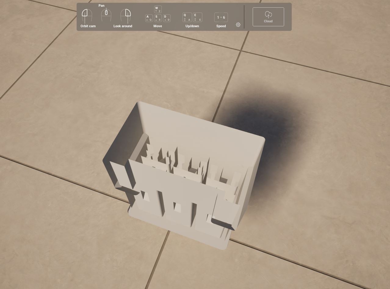

Possibly, but also it depends on what program this STL file was exported from. I have imported it into other software and with the exception of Twinmotion, where some faces seem to have their normal faces reversed, it looks ok.
Hence my comment.
It was Catia
