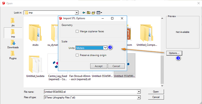

You can select the units to use when importing (see image.) STL files do not specify a unit. Most software that reads and writes .stl files assume the unit is mm. You can try to import using mm, but heed what John said. You will get better results if you import using Meters, perform any modifications, then scale down before exporting using mm as the units for compatibility with other software.

Many thanks Jim (Foltz). I had completely overlooked the ‘options’ button in the import window. With units set to mm (for objects saved in mm) my files are now opening correctly. PROBLEM SOLVED HURRAH!
