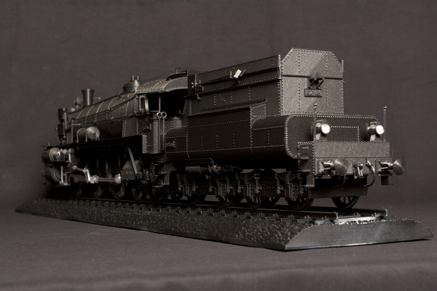

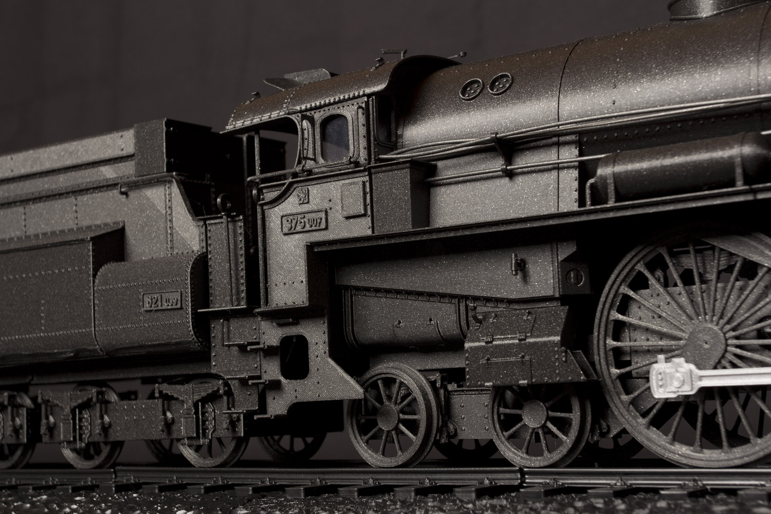

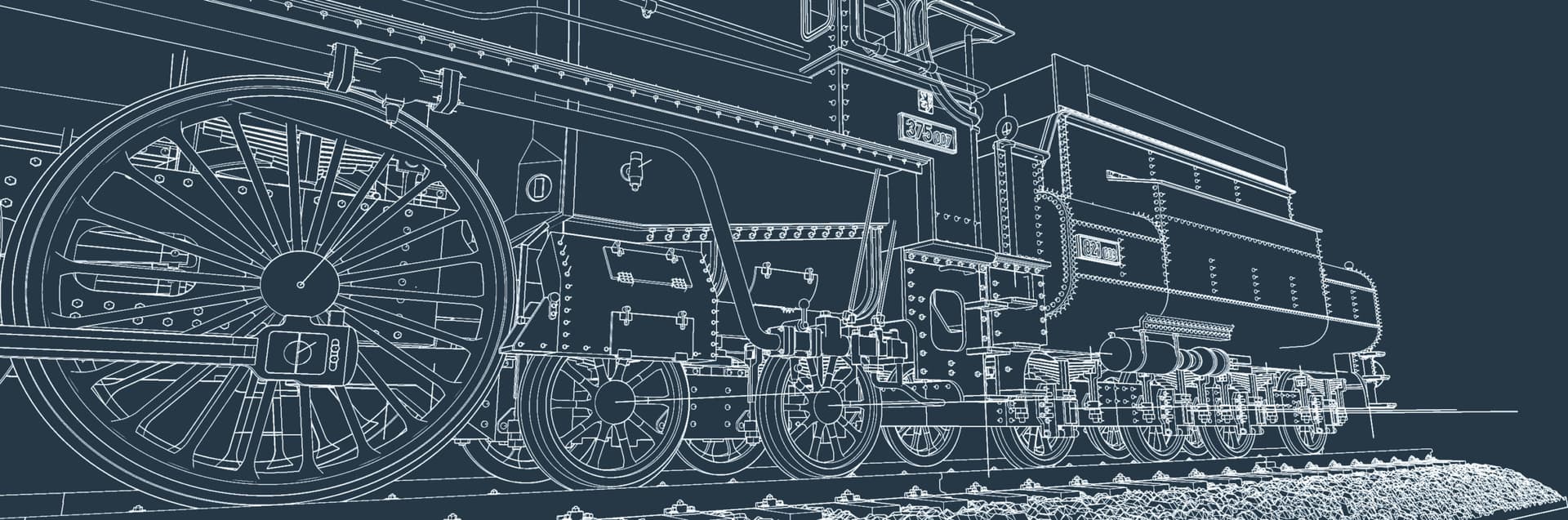

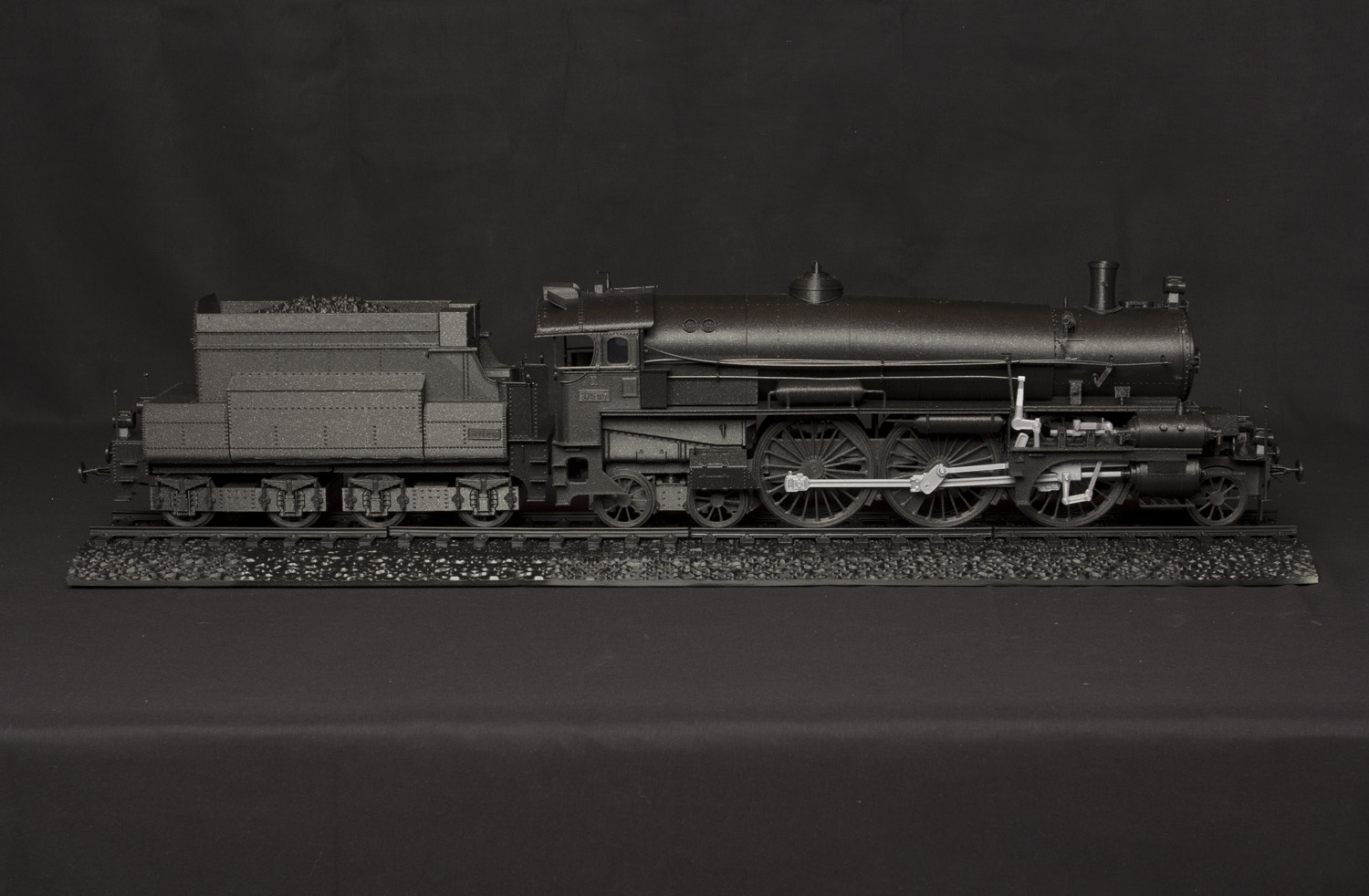

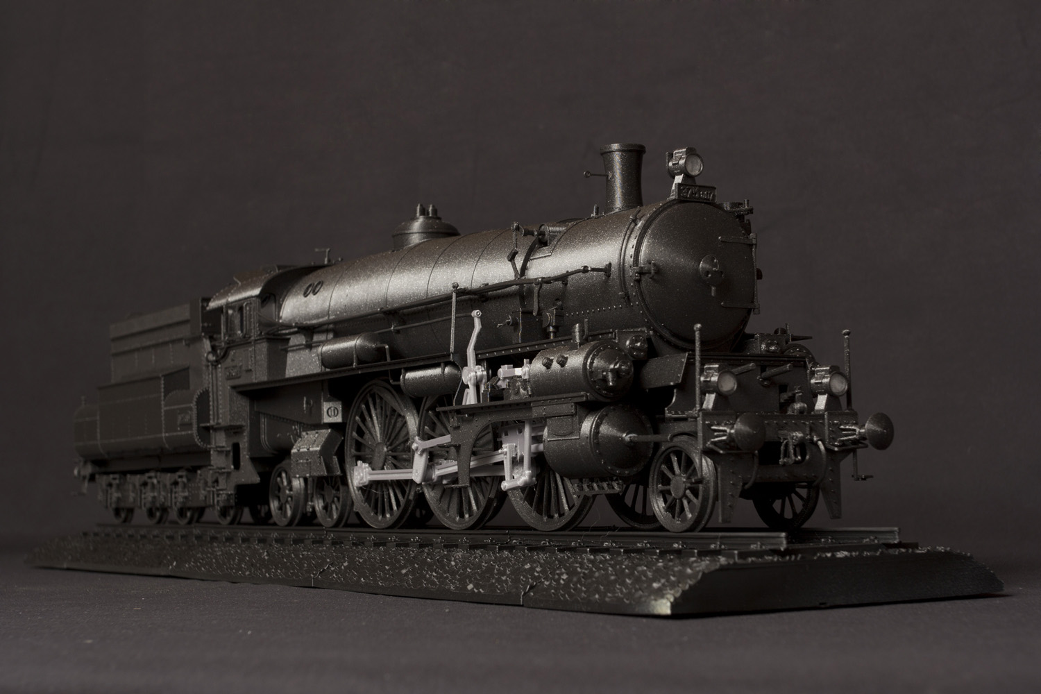

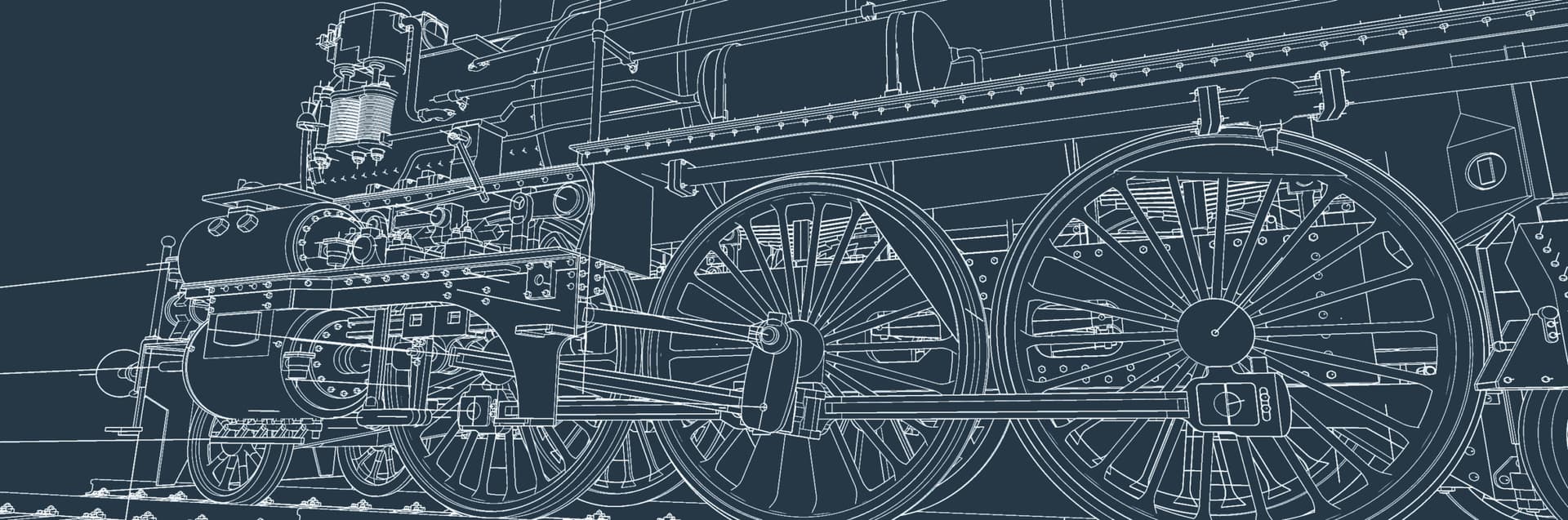

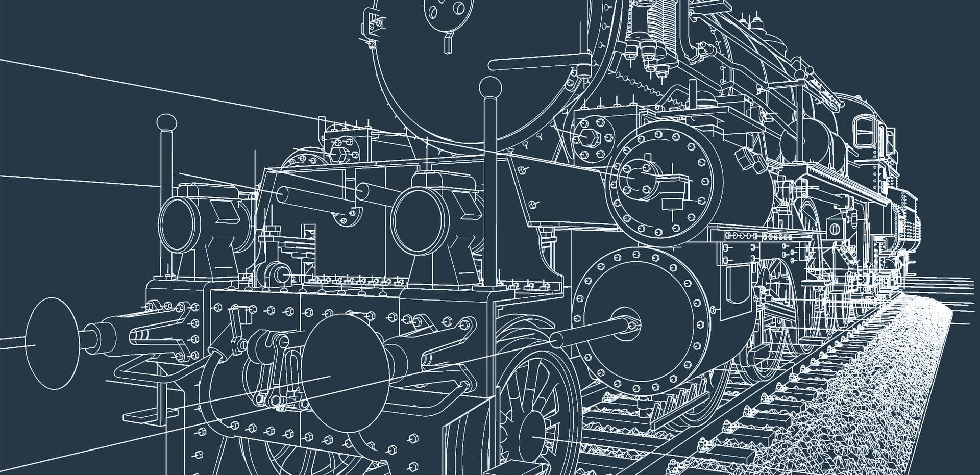

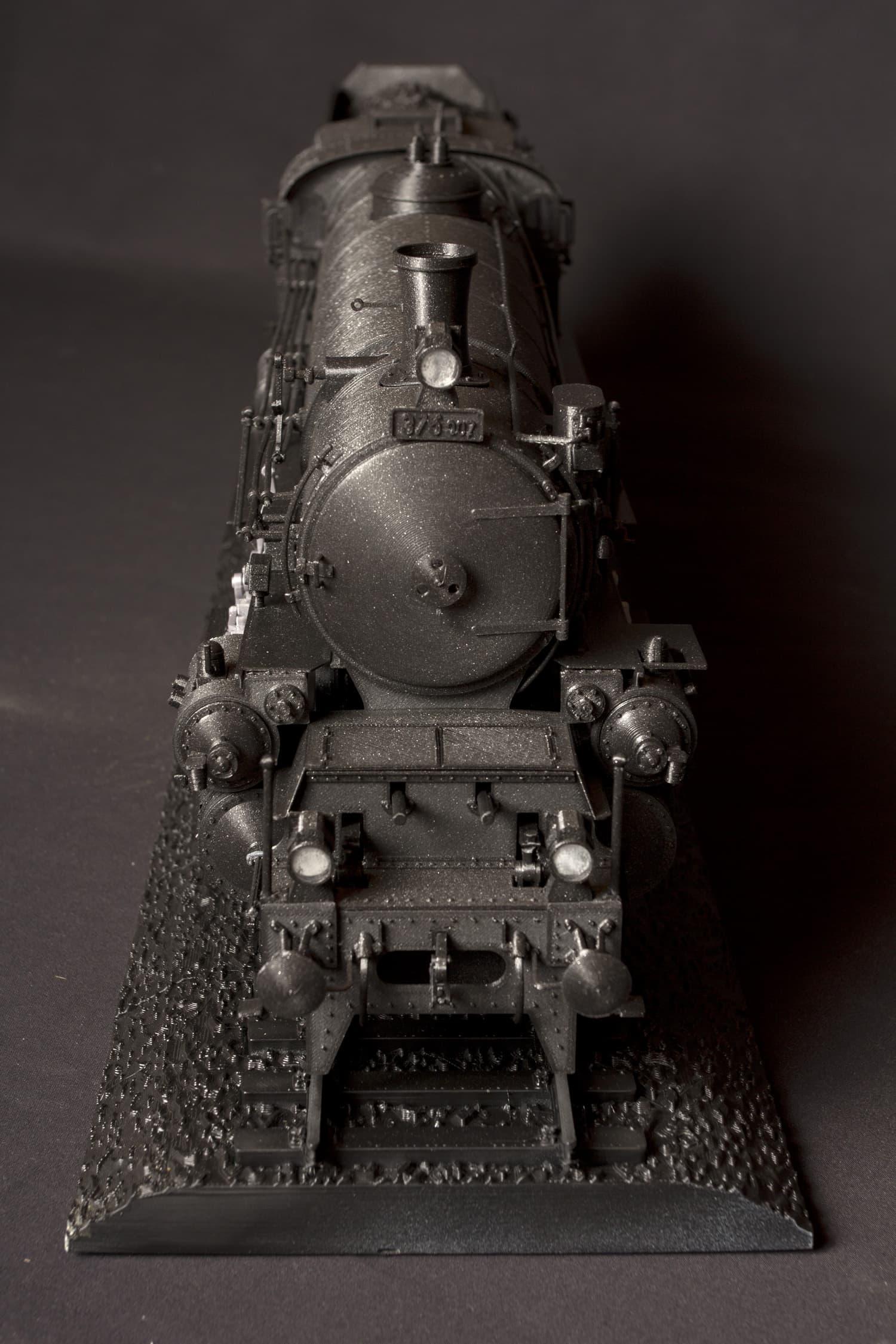

This is my the latest personal project of steam locomotive type 375 in the scale 1:25. I drafted it in Sketchup 2020 and 3D printed on my microfarm of three Prusa MK3S printers …

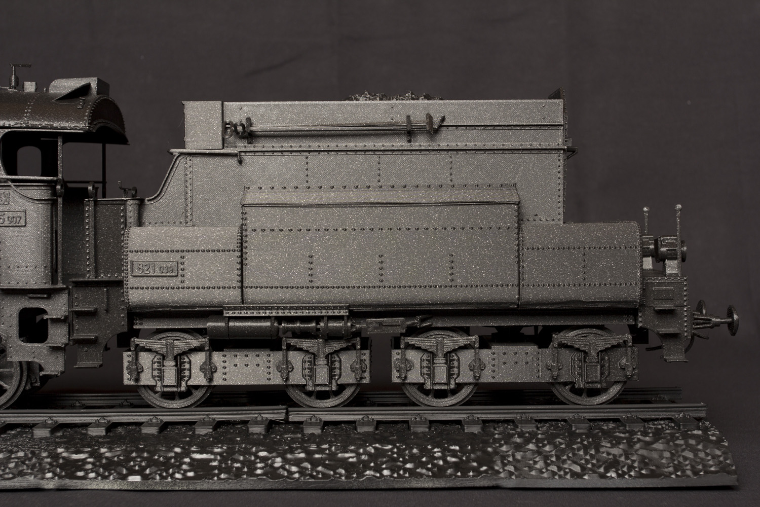

Truly incredible…couple last Q’s…were majority of parts printed with black filament? And if not can you say how much/type of post-print work was needed to achieve this level of finish?
yes, there are so many parts. Last time I made my the first model of steam locomotive and I wrote instructions for 3D print with list of all parts. The model had 300 parts. You can see here for the instructions : instructions.pdf - Google Drive
This model is more detailed so I thing it has about 100 parts more.
This model is printed from PLA filament Prusament Galaxy Black without post processing.
Amazing work, I am extremely impressed you were able to that with SketchUp!! That is incredible. Love to know how many hours in the drawing prior to sending it to 3D printer. Thanks for sharing gives us all a positive boost of what is possible.
Thank you! Sketchup is really great to make this model. It’s necessary to use solid components and solid groups and sort parts of model to groups (or components) and tags (layers). I don’t know, how many time needed, but I think it was around 150 to 200 hours of drawing. I made it in my free time and it took half of year…
Thanks for responding, you have great organization and passion, not to mention concentration. Thanks again for sharing. Can’t wait to see your next project.
