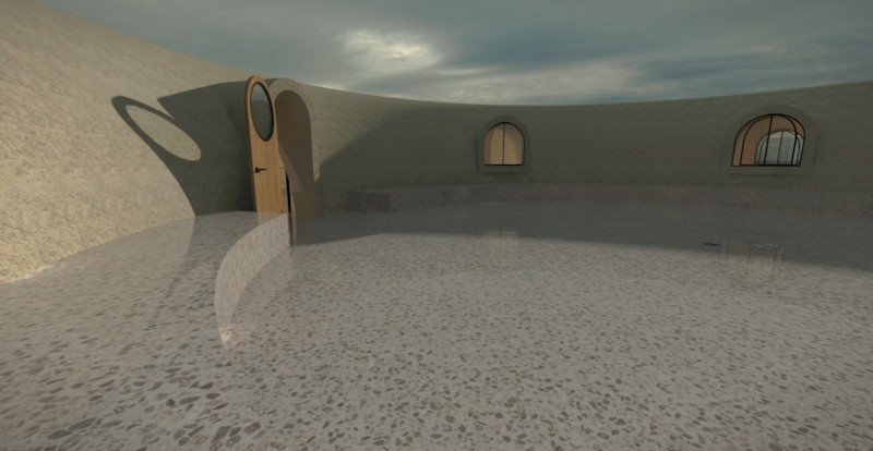

Here’s an update. Next up, windows…

I added some furniture and lights.

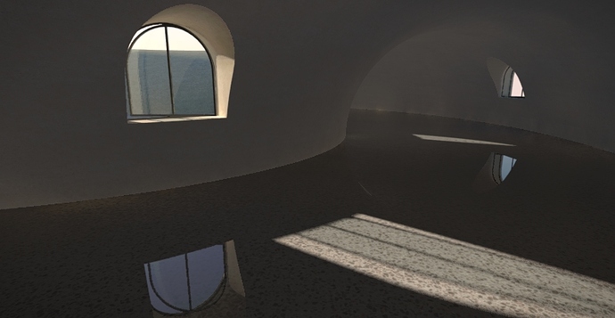

I added some chairs, but can’t figure out how to put the point light into the glass sphere. It doesn’t let light through the glass, so I just put the point light below the light and it casts an undesired shadow. I’m going for an opaque shiny white sphere around the light bulb. I’m still learning this rendering thing.

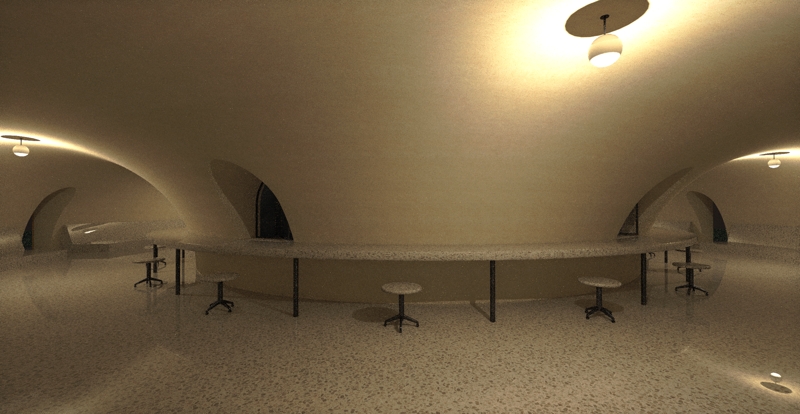

Next up, appliances & furnishings (seat cushions). I’m not sure where to put the bathroom, but I was thinking of making a modern outhouse with a washer/dryer, bath/shower, storage, and trash/recycling all in one room (but maybe with a partition wall). Maybe the room could be a hemisphere and have roof over the path from the house to the outhouse… The bedroom would be on the bench in the house. Maybe there could be a spot that fits in a mattress. All in all, the house might end up only having two rooms, an inner yard & an outer yard.
Another problem I’ve having is figuring out an artistic looking driveway or garage plan… I don’t want to ramp up the costs too much, so I’d prefer a driveway. But I see merit to choosing a garage too, such as protecting your car from weathering and stuff. I’m considering making the driveway a ramp underground, then just putting a roof over the submerged area. But I’m not really satisfied with that design because of costs and I want the driveway/garage design to look cooler.
…I just realized the acoustics in an open space that big might be really echoey. Maybe it’ll get better if I add enough stuff inside… Carpet would help, but I’m not a big fan of carpet… And I want to keep the half-torus room open for walking around the roundabout.
In case you were wondering, the inner yard has a round seating area and a drain in the middle for when it rains.
Your “house” displays an interesting mix of a flight of fancy with very particular detail (like the type of roof finish and he drain in the courtyard. You must be thinking of practicalities because of your comment about garaging. But, as a house designer, I keep wondering about so many other things, such as…
If this is a house, where are the rooms? Your screenshots make it look like a modern airport lounge. How will you get from one room to another?
If the house is built in a temperate zone, is there an issue with the inefficiencies of the form? I mean the ratio between volume and exposed area of the envelope.
By modern standards, the house connects poorly with the outside. You only have single doors and quite small windows. It is likely to feel a bit cave-like. The low natural light could be helped a lot by introducing rooflights, maybe.

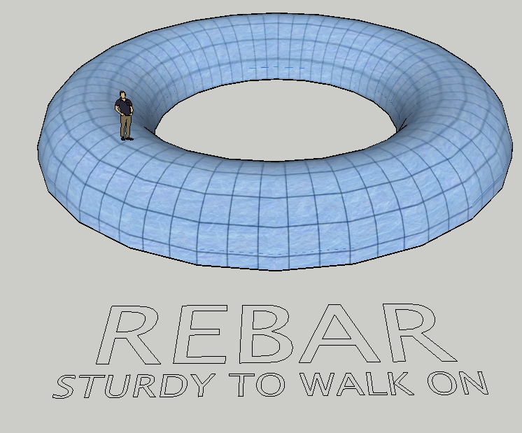

If you conceive that it might one day get built, are you bothered about how it would be framed? You have double curvature, the most testing thing to construct because nothing is straight or flat. A liquid roof finish will require something like a ply surface to adhere to.

There are two rooms.
Main room
  • Table/Counter/Sink/Dish storage/
  • Fireplace/stove/Food storage
  • Seating
  • Bed/desk/dresser/storage
  • TV
Cleaning room
  • Laundry
  • Cleaning supplies storage
  • trash/recycling
    • Toilet room (partition wall)
      • Shower
      • Sink
There will be a roof over an outdoor concrete path from the main room to the cleaning room. In the main room, there is everything you need to survive, so there’s no need for walls separating the bedroom from the kitchen from the living room, etc. The washer & dryer are noisy, so they go in the cleaning room. Maybe the dishwasher should go in the cleaning room too, so the main room is serene and relaxing. The house is designed for one person, so there’s no need for private spaces because the house is a private space. The bathroom is in the cleaning room, so that space gives privacy when you need it.

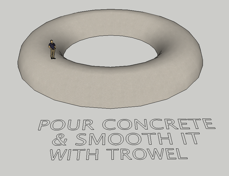

Dome houses are extremely efficient at maintaining the temperature indoors, but insulation thickness is variable depending on the climate zone. Also, monolithic domes are resistant to fires (concrete doesn’t burn) and hurricanes (reinforced concrete is very strong and domes are aerodynamic).
I prefer a cave like house with low natural light. I feel like the point of having a house is to protect you from the harmful UV rays. I wouldn’t want to get a sunburn indoors. But the house does have 12 windows. I think it’s not terribly dark in the daytime render I made. Also, the inner yard has no shade from trees, so you can go outside if you want some sun. But I am considering increasing the size of the windows, but windows are expensive.
And once it’s dry you can remove the plastic and add spray foam insulation on the inside, but I’m still trying to figure out an easy way to put a wall over the interior insulation.
I haven’t completely thought out the construction method yet.

Sure but this ain’t a dome, nowhere near. Curvy does not a dome make. As I said, its the ration between envelope and volume that makes for efficiency. A dome complies but a torus doesn’t.
Hence my comment about temperate zones. Here in the UK we don’t have to worry too much about UV rays. We do have to worry about frost and damp. Concrete can be watertight if stable and made with the right mix and thickness. If that applied here, you wouldn’t need a roof finish other than the concrete itself.
No indeed because I suspect your method would have serious problems, starting with the weight of wet concrete on your inflated torus. I guess it must be theoretically possible to use a suitable material and inflate it enough to withstand the loads but I don’t know whether it would be practical in reality. Plus, how do you keep the wet concrete in place whilst it is drying? Even if you could make it dry enough to stay in place without a former, how would you walk on it to “smooth it with a trowel”? When you pour concrete in a foundation, the trench is the former and you pour it wet enough to be virtually self-levelling. It would be a mistake to try walking on it unless you want to disappear for ever.

The section of the structure is an arch, which is still a strong structure even if it’s not as strong as a dome.

I thought concrete was porous without a finish. Also, concrete is extremely prone to cracking when the Earth shifts even slightly, so I would feel better with a roof finish. You might be right though, but I haven’t heard of watertight concrete before.
You might need to lay a thin starter layer of concrete before you add more weight. I don’t know. The air pressure in the bubble would have to be pretty strong. Think about how inflatable bouncy houses can support people jumping and how inflatable mattresses can support people too. So something like that, but with enough air pressure to hold wet concrete. You might have to do sections at a time to reduce the weight. If you get quick set concrete (with sand and aggregate rocks added in) and use a low moisture content, then it will be thicker and easier to adhere to the walls. As I said, I haven’t quite figured it out yet, but I’m giving you guys a sketchy idea about the construction method. Yeah, this house would be good for hot climates.
