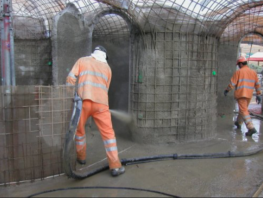

Hi, when following this it reminds me at the swiss architect peter Vetsch.
Take a look at his work and the ways to get it done using spray concrete.
I think it can be done, have seen it for builing domes…
Look on youtube for shotcrete dome.
Look at Paolo Soleri, his dome house and maybe Arcosanti.
Edit: or Dante Bini (company?) who did this house.
Did Peter Vetsch use a steel frame & shotcrete to build his houses? What about insulation? Does the grass roof insulate it? His house designs are amazing!

The spray on concrete is interesting but has a basic problem. Good quality concrete can only be achieved by minimising bubbles of air trapped in the mix. Traditionally, that is done with a poker vibrator. You can only use one if the concrete is contained within some kind of retaining structure. If you tried it with spray-applied concrete walls you wouldn’t have concrete walls so much as a concrete floor.
Here endeth the latest lesson.
This “problem” isn’t a problem because : “Shotcrete is placed and compacted at the same time, due to the force with the nozzle.” according to Wikipedia!
Well, there you go, problem solved. Providing compacting means de-aeration… Makes you wonder why people go to all the trouble of building formers. They must be crackers.
If I had to build it, and I could get away without steel reinforcement, I would be much happier with a rigid formwork that I could loosen and form in sections.
Maybe it would look like this:

As far as i know it means the same, if you take the air out of the concrete it becomes more compact.
