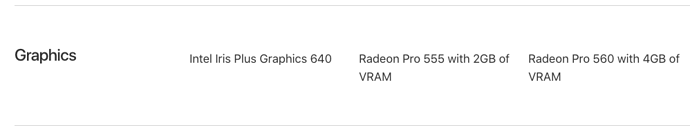

Well at least that sorts that out: Mac Mini not an option However, I see that the base iMac also uses an Intel graphics card now. You have to upgrade to a Retina display to get a Radeon card. My current machine has an nVidia card and that has always performed well.
Yeah. That’s why I bought the MBP when I did. It has an Nvidia card which has always been good. The fact they don’t offer Nvidia GPUs now is why I ended up replacing my MBP with a PC laptop for my roaming machine.
