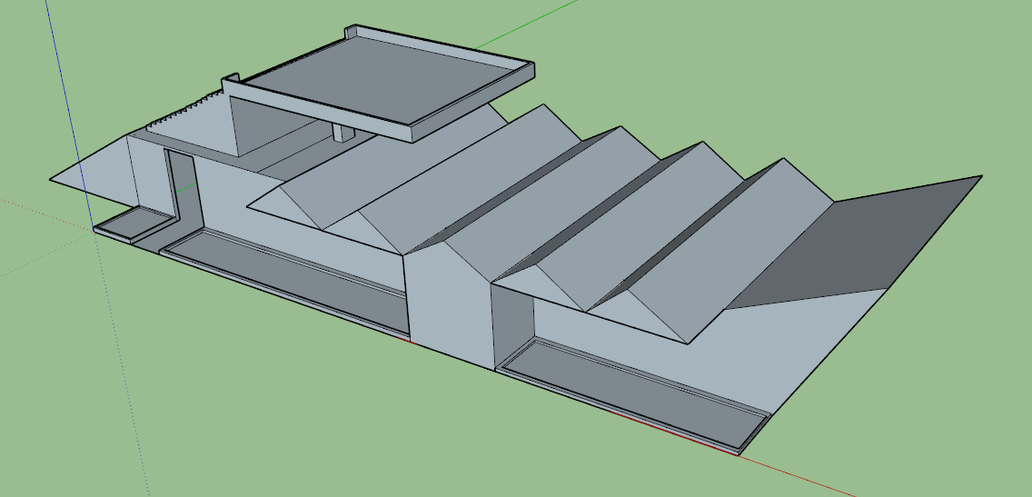

Exporting to where? A rendering application? If that’s the case, it’s because nearly every face is reversed in your model. Correct the face orientation and paint the front faces. That should take care of the problem.
This shows the face orientation after reversing the faces.

Select the face and right click. Choose Reverse Faces.
i have no clue how the hell it even got reversed lmfao
Select all reversed faces, right click and choose Reverse faces.
If any are still showing wrong, select one face that’s the right way out then right click and choose Orient faces. If you still have a few wrong ones, select them and Reverse faces again.
