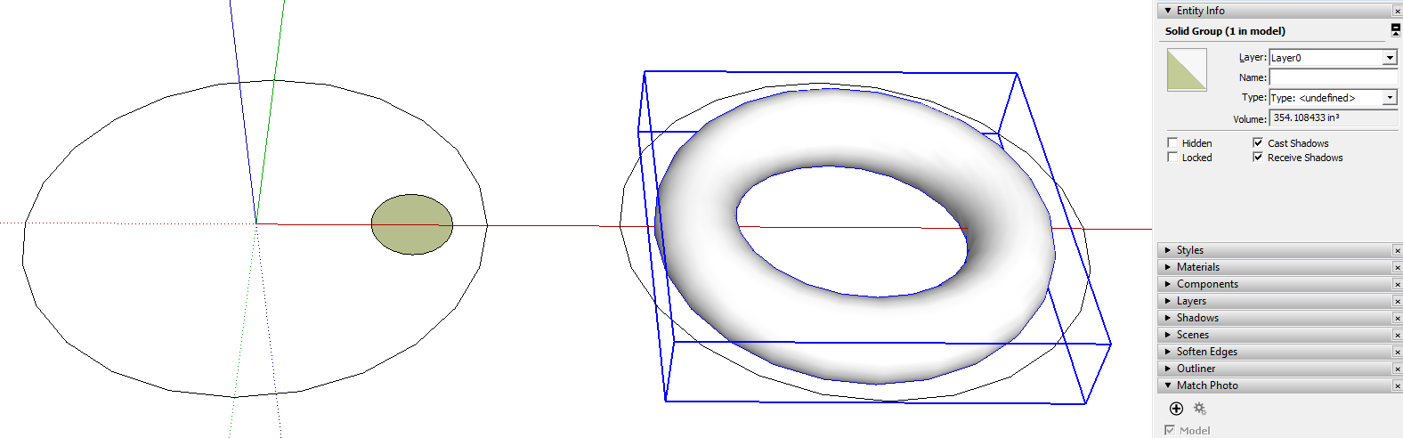

Yes. You could switch the Face Style to Wireframe. then you’d have been able to select and delete the path. Generally, though, I find it makes sense to set things up in the first place so the path is readily accessible after Follow Me as I did in my screen shot or make it so the path is “consumed” by the extrusion. That is, the path becomes an edge of the extrusion.
Setting up for Follow Me as I showed, can be beneficial especially if you might want to use the same path for multiple Follow Me operations.
