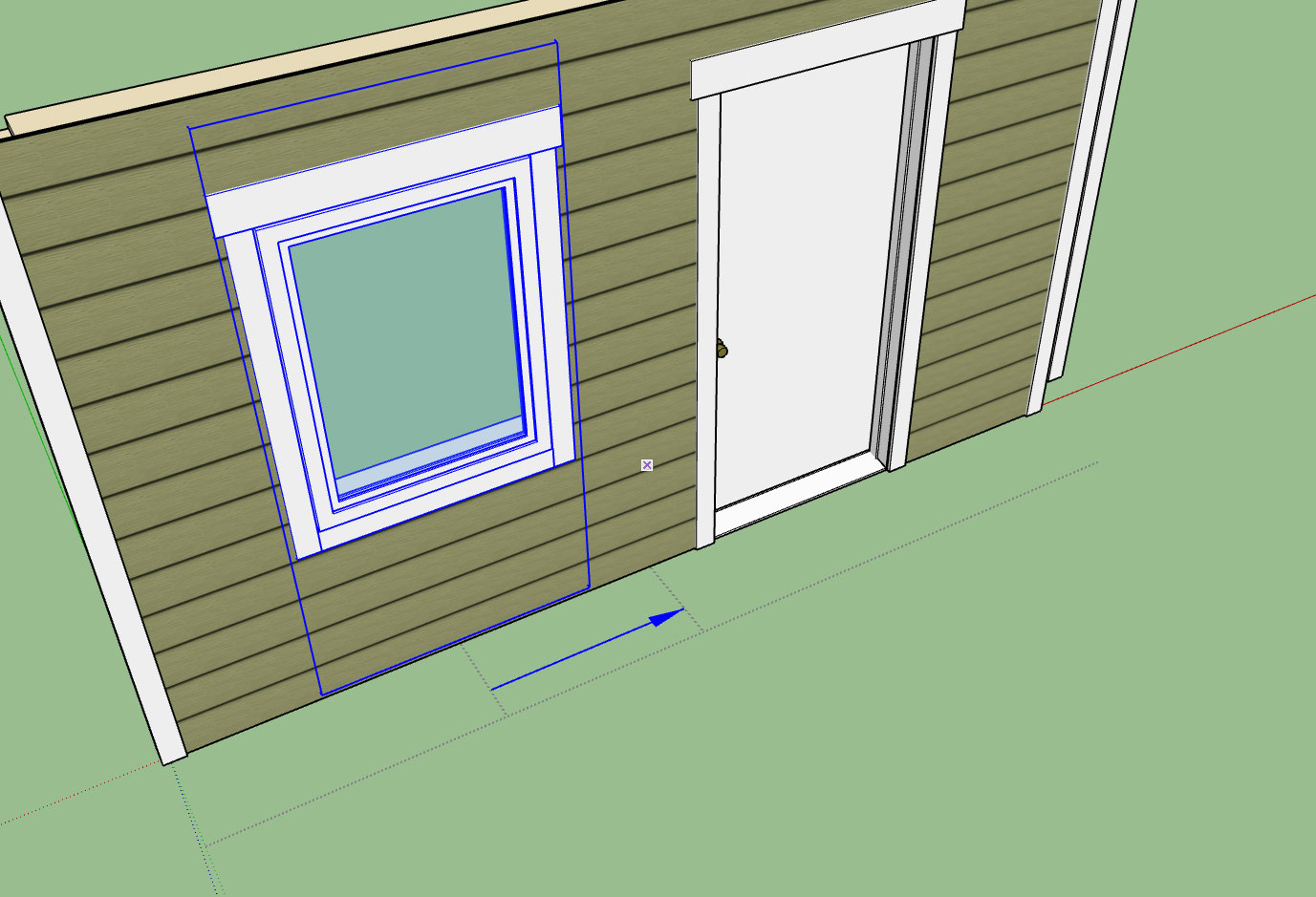

I would like to create a grid along the length of my wall (temporary) with the GL and draw method within my move opening tool.
However, after creating some temporary lines I just realized that the cursor will not snap to these lines or inference from them.

Put temporary cpoints at the intersections of the GL grid, … or just use a temporary grid of clines.
See Trimble example code here … Extension | SketchUp Extension Warehouse
I put clines in a group then delete it once the move distance is determined, seems to work reasonably well.
The only problem with creating actually geometry is that the SketchUp undo function now has this geometry added so it messes up my system slightly. Is there a way to purge certain actions from the undo function
So that they don’t appear?

Well you could temporarily set the snapping in Units options.
Yes, but if the wall is not orthogonal to the global axis system than the snapping really doesn’t work.
