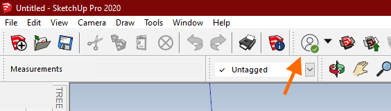

Kinda like the new user button ?
:wink:
It has a drop down menu with signin/out item and a manage license item (currently.)
Yeah, exactly like that…That little green check mark could go to a a red one or similar to alert the user to the an issue like we are discussing.
