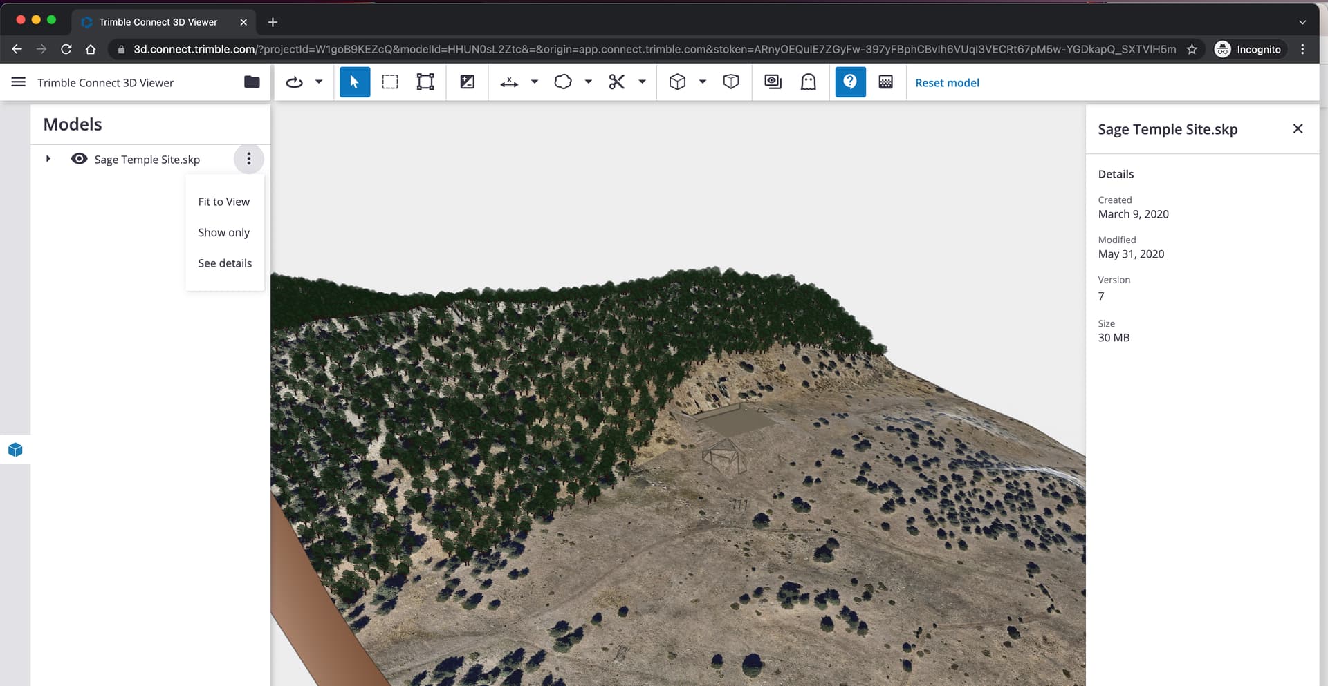

Check this file with options ‘public link’ and ‘View’ only, open in an incognito or private tab of the browser:
It only opens the 3D viewer without options to download:
