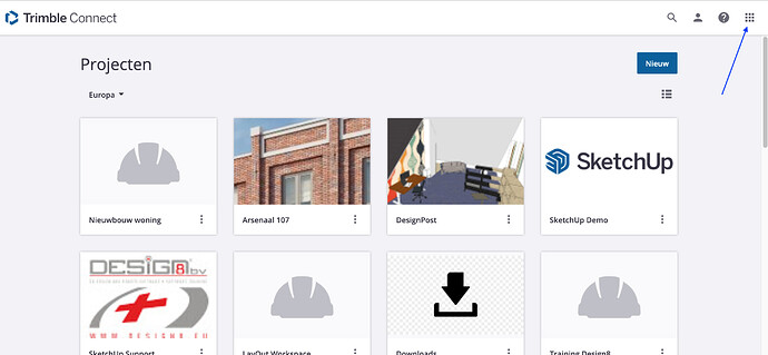

You can also use Trimble Connect. First, go to connect.trimble.com and sign in with your Trimble ID.
Set up a project or use the one called ‘SketchUp’ .

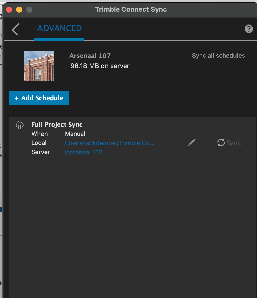

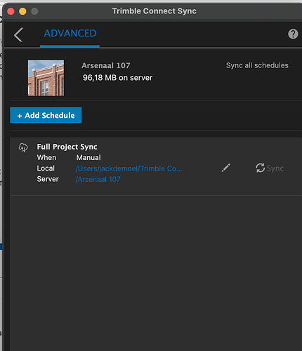

If you are planning to work from different locations or machines, it might be wise to also download Trimble Connect Sync, available if you click on the tiles on the top right:
Install Trimble connect sync and then you could set up a syncing schedule for your projects that are save here: ~/Trimble Connect Sync
