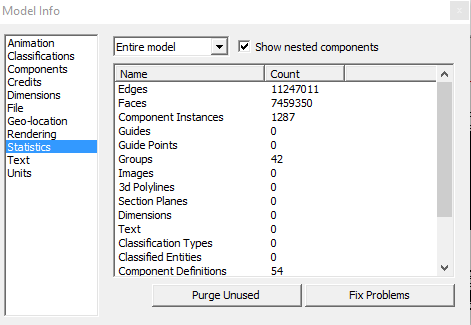

If you open Window: Model Info, what are the stats for edges?
Also, what is the file size of the model?
Can any Layers be turned off?
@josephkim626 is right on about the edges. If you go to View: Edge Style, is everything checked off (except Edges, if you are in Wireframe view)?
You could try turning off edges, and going to View: Faces Style and switching to Mono, or Shaded. Sometimes that speeds up rendering enough to at least let the model load.
My bet is that the chair is a monster of complex lines and heavy materials.
The .skp file is 53MB, I’m not the artist have no real understanding of what to do within this program, but I’ll have him look at your tips to tweak some more. Thanks.
Wow, that’s an astounding number of edges and faces.
For now, try hitting the Purge Unused button, and then re-saving the model. It won’t improve rendering, but it will reduce the file size and simplify the Components dialog box.
Also, minimize the dialog boxes on the sides of your screen. Hit the pins by the red X’s. You don’t want to accidentally open Components or Outliner while a model is struggling anyway.
