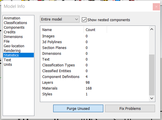

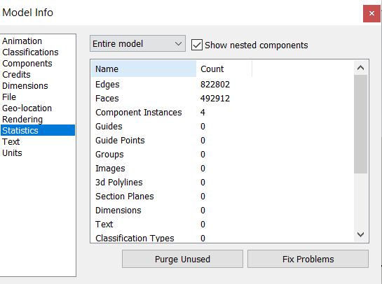

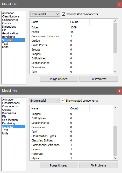

At least, post screenshots of Model Info > Statistics so we have some idea of what’s involved.
Like so…
Also, model file size can be affected by large textures without necessarily involving a lot of geometry.
MODEL%20INFO%201 MODEL%20INFO%202
In my opinion, models with an edge count nearing a million are quite large and complex.
In my experience, the Rhino to SketchUp exporter creates way too many edges and faces out of the Rhino NURBS surfaces even when the polycount slider is set to its lowest. I have got better results (a lower polycount) by first converting the surfaces to meshes in Rhino and using the Rhino polyreducing function with quite low parameters before exporting to SketchUp.
