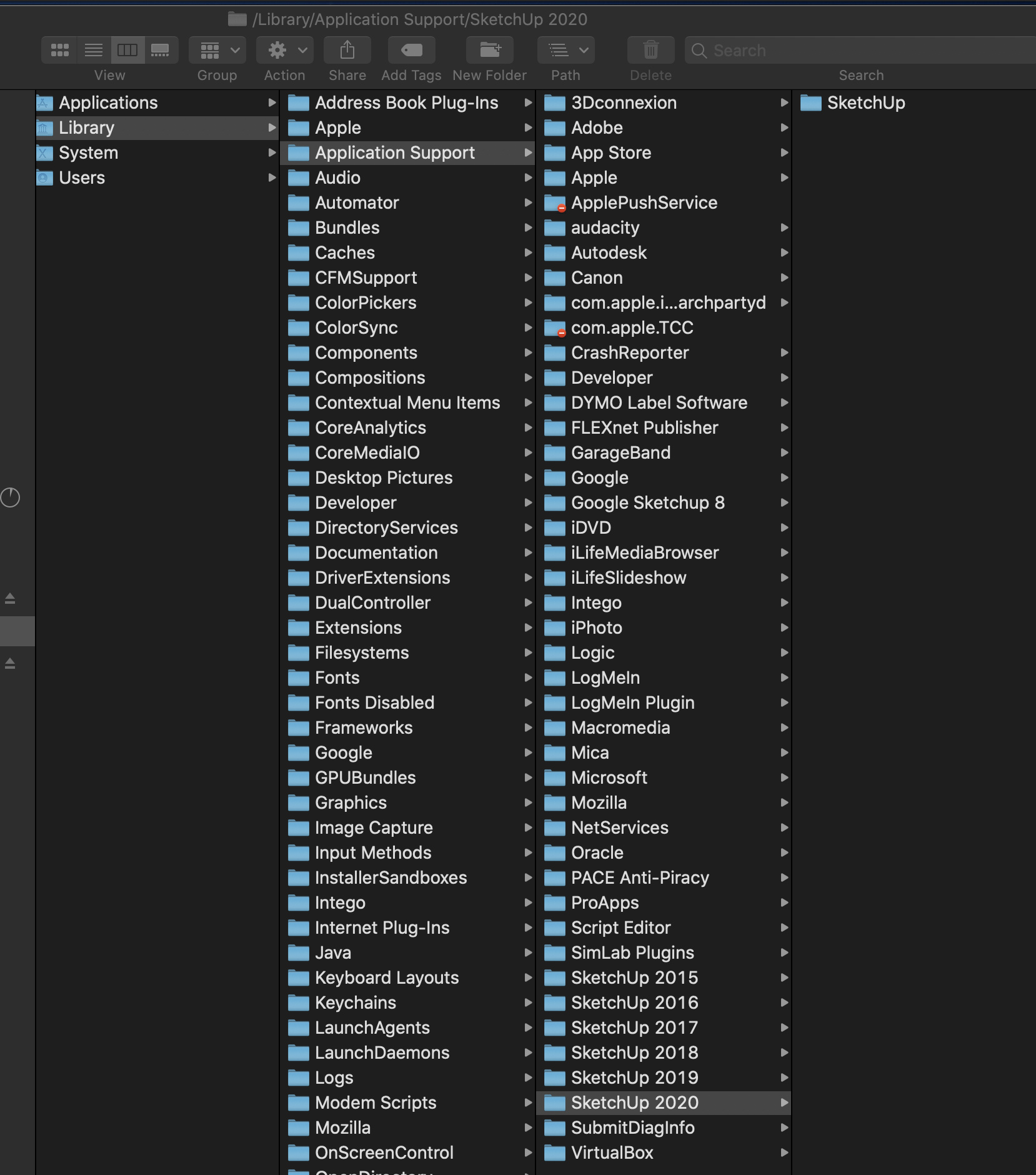

After Uninstalling/Reinstalling 3DX, with no firewall enabled, checking the library folder everything is in place. As a matter of fact, all versions of SU had the plugin folder structure copied correctly.

I updated to 10.6.5, to see if 2020 was working ok. It wasn’t. I tested in 2019, and that worked. After trying many combinations I ended up in the System Preferences, 3Dconnexion, and under Tools I used the Install Plugins option. After that things were better.
Even then, it seems that the first version of SketchUp you open owns the Space Mouse (in my case). Quitting all versions and opening any one of them, lets that version work. Things feel correct in 2020, and no unusual increase in memory usage.
I did also hit another problem, connecting the Space Mouse via a dock would often not light up the LED. Using a dedicated Belkin USB-A to C adapter works consistently.
Well… Here is something. I deleted all previous SU versions (2013-2019) from the applications folder, deleted the instances of these from the Library plugins area thinking there could be conflicts. Uninstalled/reinstalled/rebooted with a fresh 10.6.5
Same issue. as a matter of fact the Navigator responds but acts like a mouse. Moves the cursor.
So I did the install plugins option… That brought back every instance of all the old versions I had deleted!
