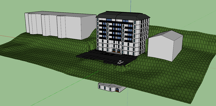

Your model is terribly bloated.
Using Model Info > Statistics > Purger Unused… removes ~80% of this…
After that it works fine for me…
Is this what you hope to see ?
I notice that several faces on the roof and the carparking are reversed, but this is just sloppy modelling unlikely to cause issues like you report…
Also, why is there a rogue bit of the building far below it ??
That’s exactly what I hoped to see. I’m very self taught when it comes to SketchUp (usually use ArchiCAD), so im not sure what it means to for faces to be reversed? This has probably been the source of problems in renders in the past. What does this mean and how do i stop doing it?
(Also the rouge building is a component, I planned on doing interior’s later on and editing it like this)
