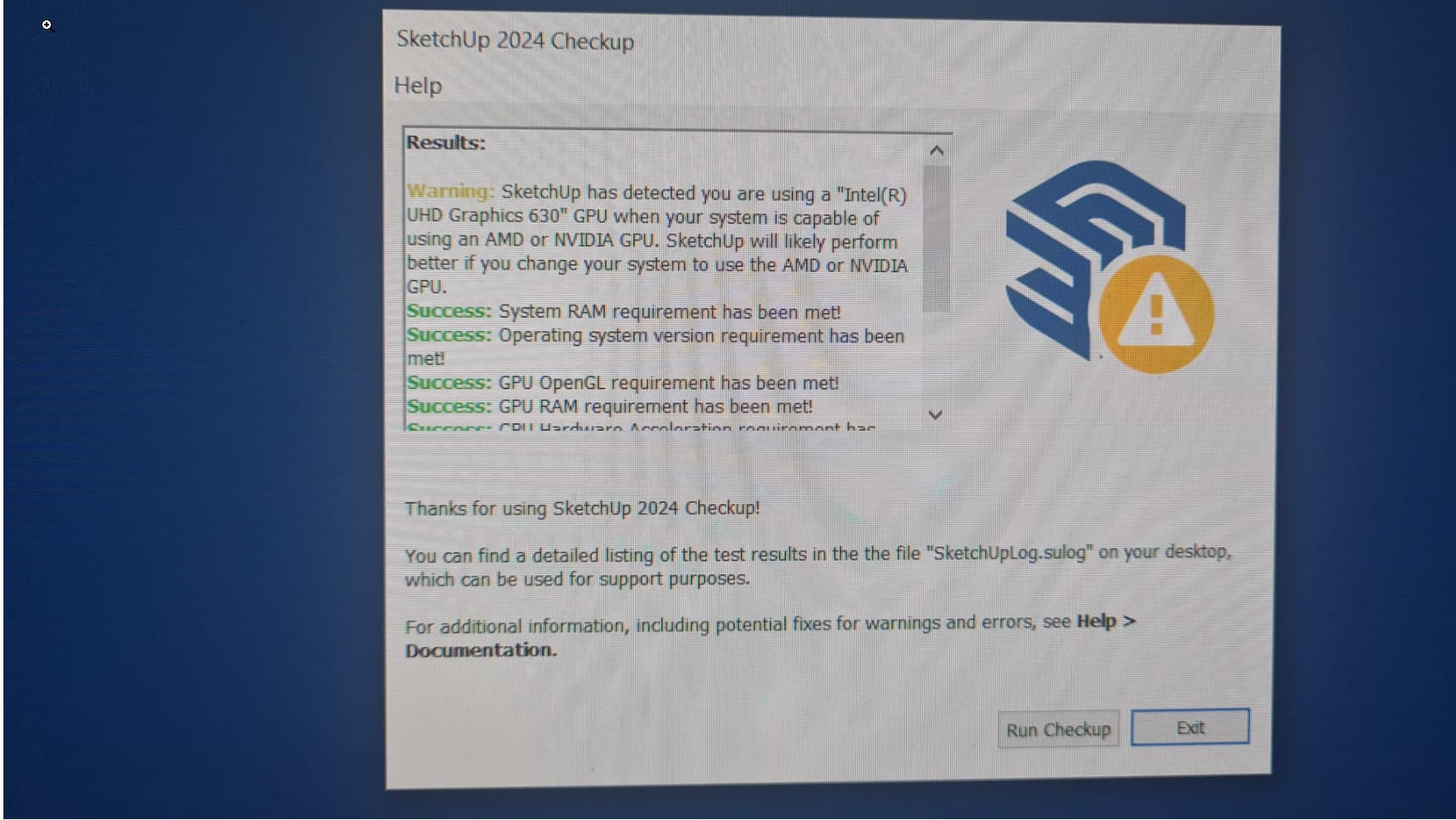

I have made a Sketchup checkup, and was surprised to find out in the results of the check, that in spite of my 2070 choosing, yet Sketchup use the Integral card.

Have you updated the graphics card driver from Nvidia? (Not windows)
In 2024 did you try turning off the experimental engine and use the classic engine?
Since you have been using 2022 without issue and 2022 hasn’t seen any updates - something must have change outside of SketchUp on your machine.
Is it possible to force laptop to use 2070 graphic card?
It’s been too long since I’ve used PC, so I don’t remember how to do it, but I do believe it is possible.
Have you set the properties in the Nvidia control panel?
