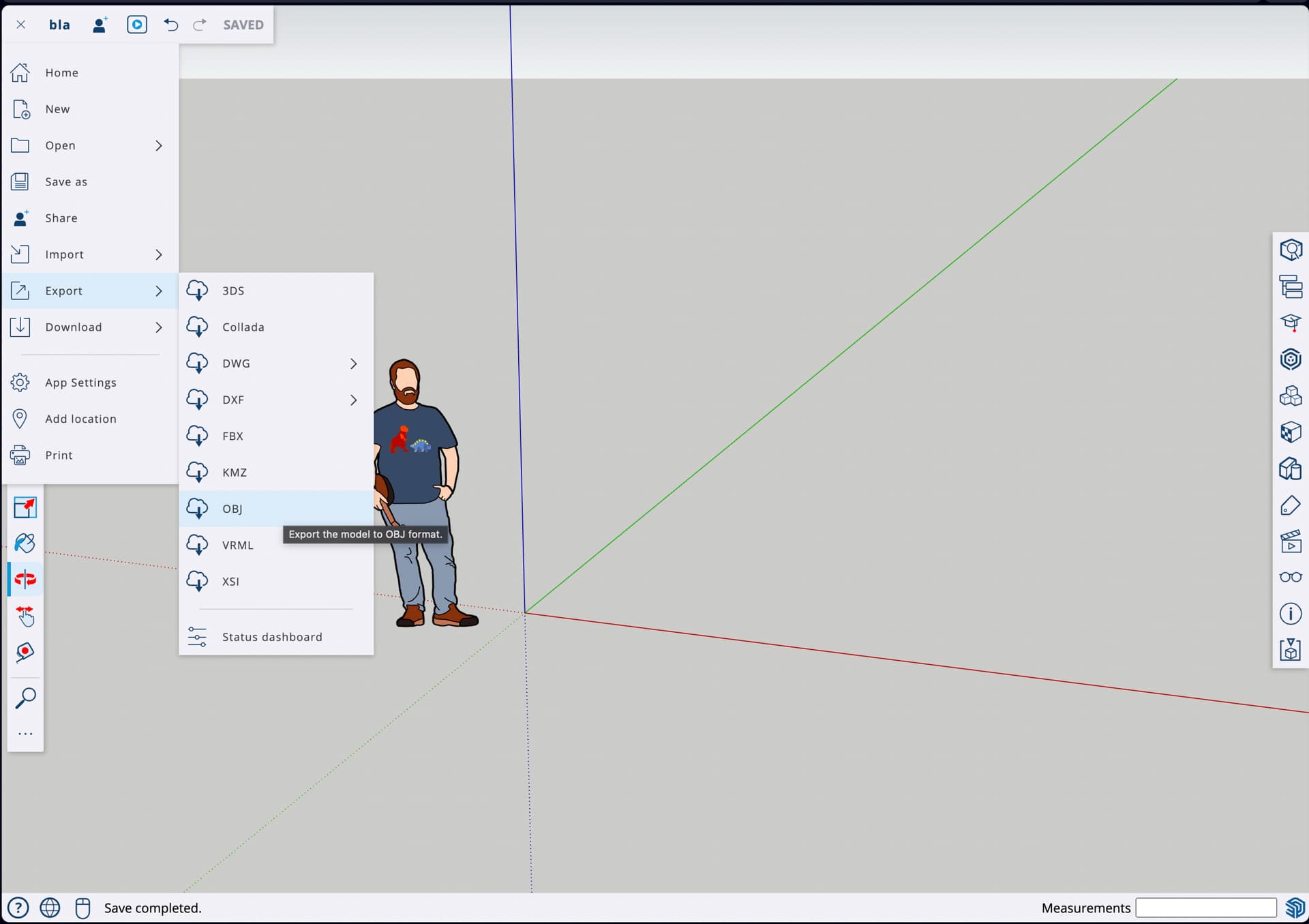

It works fine for the rest of us, so instead of ranting about it why not try to figure out what the problem is? When you go to export under the upper left three lines menu what options do you see? Can you post a screen shot like this one below showing what your menu looks like? Hopefully your 25 years of 3D experience will help you do that.

You’re on ipad you muppet :slight_smile: .
You’re in the Sketchup for computer section, answering a question about sketchup in browser, not ipad.
And now you’re super angry and ranting about EVERYTHING while you’re asking the wrong questions about the wrong product.
geez. 25years user of 3d software would see the difference between a browser and an ipad amaright ?
ipad can export obj since last year.
Capture d’écran 2023-08-12 à 10.35.39
you see that ? it’s a rolling menu. you see how under the “Image (.png)” there is a faint line reading “Animation (.mp4)” ?
put your finger on this. and roll up. you’ll see all the other files that you can export.
it’s a standard ipad rolling menu.

That iPad interface for choosing the export option is not the most obvious way to do it. Touch where it says Image (png), and scroll the list. There are eight formats you can export, one of which is Object File (.obj).
