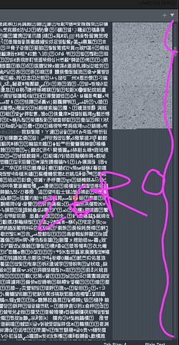

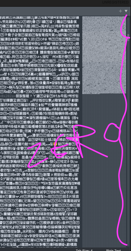

file is completely empty.
you see the bar on the right ? the small top part has data.
the massive bottom part is filled with zeroes.
any chance you have a skb somewhere ?

That file has the same problem as the first. They are exactly the same size. What did you do? Just rename the first file?
I found it and it seems to be the original file before the computer was turned off. I changed the name to avoid uploading it to the drive with the same name.
It has the same corruption.
