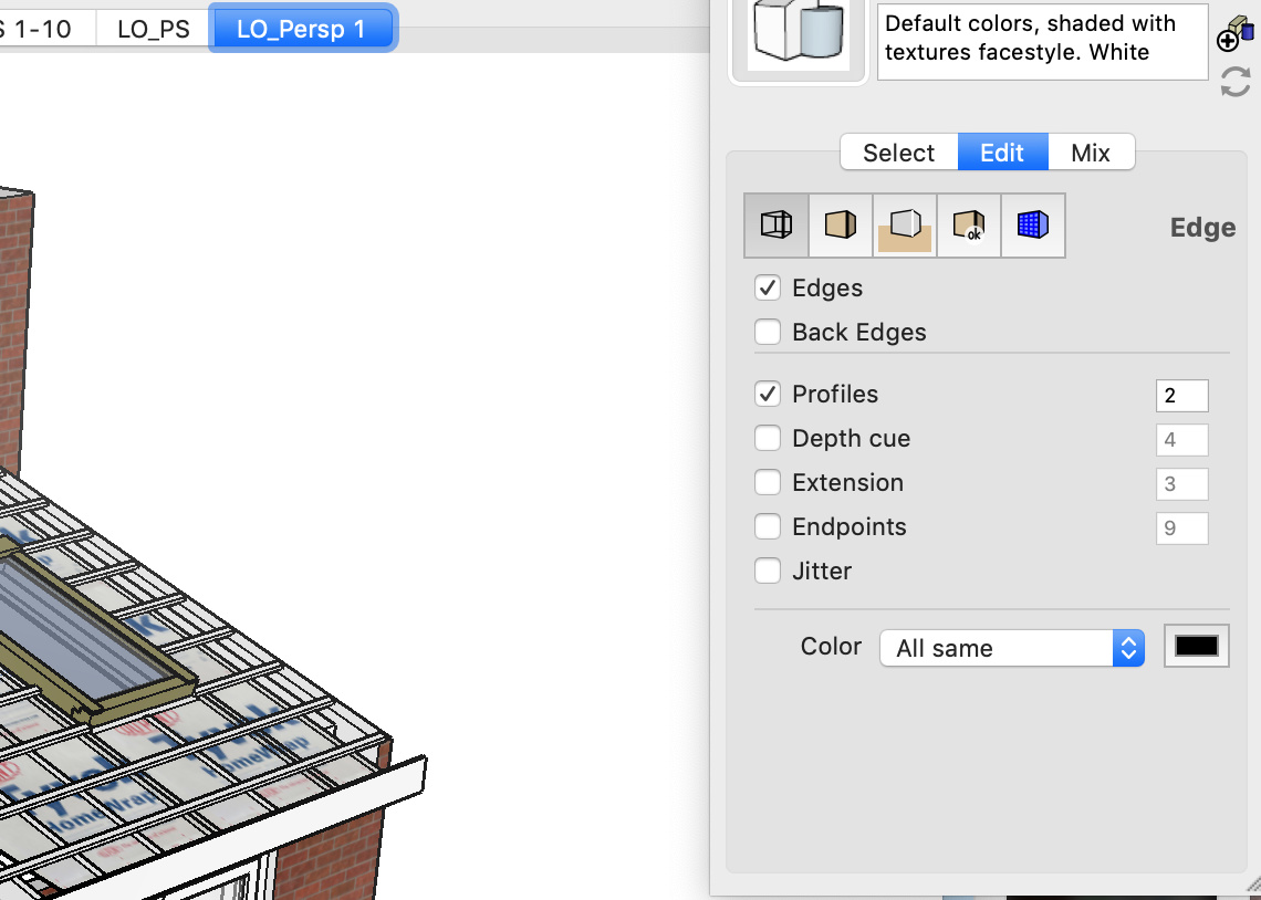

With my head held in shame, I checked and discovered that in Sketchup I was using a Style with Profiles on!!! Switched that off and Sketchup flies! Consider myself fired.

The line style makes no difference at all. This model is only 3.9MB. This model and Sketchup works fine on my MacBook Pro which is running OS High Sierra. This iMac came with Mojave already installed. The operating system is bang up to date too.

And the model embedded in that LayOut file, by right clicking and opening in SketchUp, has Profiles on, correct:

Tried it without Profiles. No difference.
