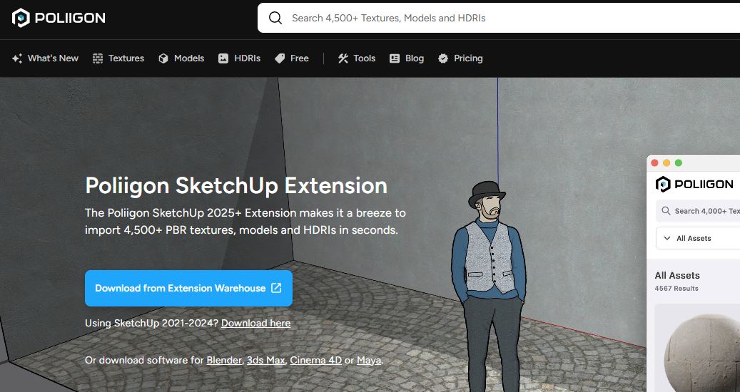

What does the extension Poliigon do?

Poliigon is a website that offers PBR materials and belongs to the well-known Andrew Price, and the extension for SketchUp allows importing those materials, or models and HDRIs.
Thanks. It was the only extension listed in the crash report that I didn’t recognize. I don’t think it causes the crashes.
