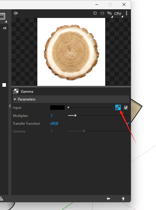

I don’t know if V-Ray treats transparent PNG SketchUp materials as totally transparent, but when I chose the endgrain material in the V-Ray asset editor, vlicked on the “Edit in V-ray” button and unchecked the box beside the Opacity slider, the log ends appeared in the render.
SketchUp materials have no opacity channel but they support transparency in PNG images. This info doesn’t seem to carry over to V-Ray automatically.
@dbordeleau , you could report this to Chaos so they could perhaps fix it in a new release of V-Ray.
