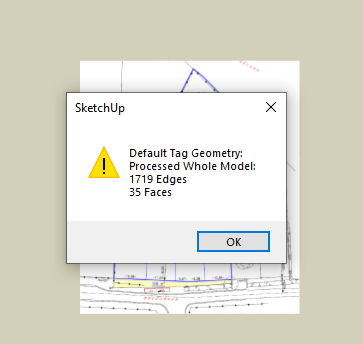

I fixed the incorrect tag usage and purged unused stuff.
This reduced the file size by about 30%.

I used a plugin from TIG called Default Tag Geometry (or Default Layer Geometry) at Sketchucation to correct the incorrect tag usage. Then I used his Purge All because it gives the report to show what was removed. Purging unused can also be done from Model Info>Statistics. That’ll show you what’s left and you can do the math if you want to know how much was removed.

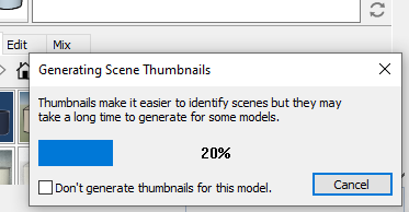

There’s a notification in the bottom about Thumbnails, disappears quickly and then it freezes.
Open a different SketchUp file. Go to the Scenes panel and in the Details menu turn off Use SceneThumbnails. Save that file and then try opening your troublesome file again.

Do you have time to click “cancel” or the “dont generate…” box before it disappears?

YES! Clicking cancel does the trick!

Glad you got that sorted. I was under the impression you’d already tried canceling the thumbnail creation but it didn’t work or I’d have suggested it yesterday.
