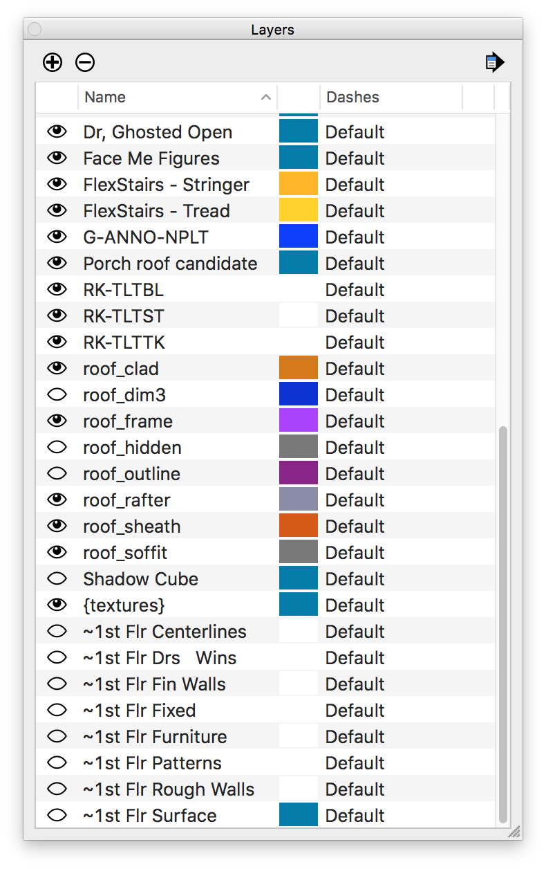

I’ve spent a little time recently trying to work with sort order, and got an ASCI table as a reference for this. One exception on the Layer Palette is that “Layer0”, is at the top, with the understanding that it’s actually “nothing” or “null” for a name, but why is it when you use the Entity Info palette to put something on a layer, the popup menu for that has a different sort order. On that menu, Layer0 is somewhere down among the L’s, and other things sort differently. Could it at least be consistent with sort by name on the Layer palette, or whatever sort order it’s set for it?

In SKP 2019 version - Order on toolbar layer is correct (the same as 2018)
In SKP 2019 - Order on the layer tray is wrong (it should be the same as toolbar layer, something is screwed up here)
Interesting. Can you show a screen shot of what you are seeing for comparison? I get the same layer order in both.
This is in 2019 from an old model. I just opened the model and added the Layers toolbar to have a look. Never touched the Layers panel.
Screenshot%20-%2012_11_2019%20%2C%208_43_32%20AM
