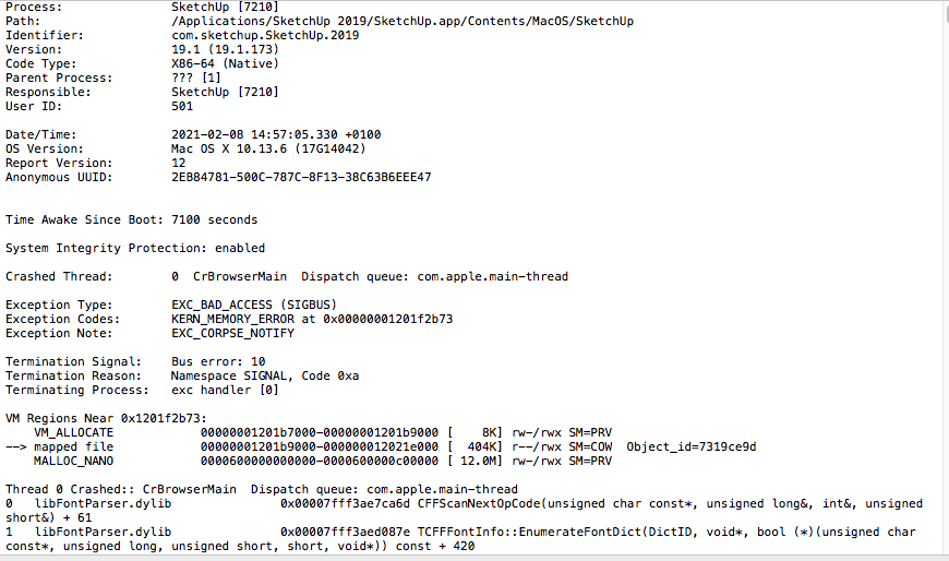

Da ieri non riesco a usare Sketchup.
Stavo impostando l’illuminazione su Vray quando si è chiuso. Ho provato a riaprire e niente. Non si apre piu… Bugsplat tutte le volte.
L’ho disistallato e rinstallato e nulla.
Qualcuno mi puo aiutare?

Did it but problem is still there…
:weary:
That crash report says there was a bus error, which means an attempt to access a non-existent address in the system. That’s a pretty serious error and usually involves hardware (either a hardware failure or a code error that tries to access hardware that isn’t present).
From the limited amount in your screenshot it isn’t clear what the offender was, but I’d try completely uninstalling V-Ray and see if the problem happens when V-Ray is not there.

I tried it, I completely uninstalled VRay and Sketchup as well… Installed just Sketchup and nothing… problem is there…
I’m an architect, not good with computers at all… I’m trying to understand something about that error… looks really serious… thanks for you help
On a second look, I see that the crash occurs in a library that is trying to process a Font (last two lines of your screenshot). I wonder if the file that was open at the moment of the first crash has a problem with some Font it tells SketchUp to use? When you restart SketchUp after a crash, it attempts to reopen the file from the time of the crash. If that file is defective, that can get you stuck unable to open SketchUp.
