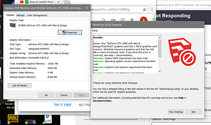

The screenshot is helpful but you require users to determine the problem by being detectives. You’d be better off to explain what else may be happening on your end.
After carefully studying the screenshot I see that Checkup indicates your graphics card has only 1 mb of memory while your sysinfo shows that your graphics adapter seems adequate with a notable exception of having NO system video memory. I suspect this is related to your issue.
Have you updated the nVidia drivers? Or, is it possible that something else needs to be tweaked?

It’s normal for CheckUp to show only 1Mb of memory. It’s a well known “feature” which is caused by a bug in Windows.
Your graphics card should have some memory, though.

The fact that the video system memory equals 0 is troubling. Other factors indicate an adequate system, which is why the suggestion to update drivers was offered. Try disconnecting one of your external monitors and reinstalling SketchUp to see if the software performs as expected. If and when it does, reconnect the other monitor to determine if that fixes the issue.
