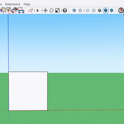

You can find your licenses by using the extension itself.
GIF 29-05-2024 11-58-15 PM
