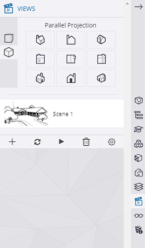

Use the View menu on the right to change to top, this will position you above the z axis.
But nothing you do will stop the fact you are in a 3d environment.
As Dave said, you’d be better off learning how to use the tools in general, then see about 2D.
It’s a 3D modeling application. You don’t change the axes from 3 to 2. Just go to Views and choose Parallel Projection and then select the view you want.

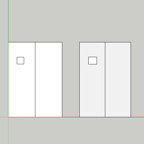

I think that the disconnect is that there are no 2D tools or 2D mode in SketchUp. Even if you view from above in parallel projection, you are STILL drawing in 3D space. Asking “how do I draw in 2D with a 3D program” is like saying “teach me to drive this submarine, but only on above water.” You still have to know all of the tools to move the submersible, even if you are using it as a boat.
The difference between a 2d drawing and a 3d model. In parallel projection from above they look the same. But when viewed fully they are very different things.

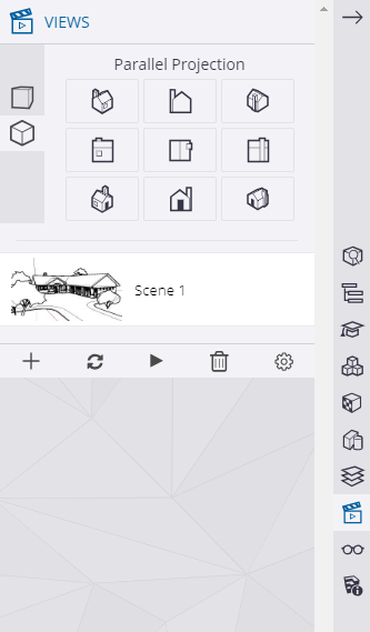

I gave you a screen shot to show you where to find it. Does that not help?

Thank you for your explanation. I understand this now. But I still don’t see where the top view parallel perspective is in the tool bar. I want to work from that view as this is the picture I have in my head.

@DaveR pretty much showed you everything… click the views icon on the right side, select Parallel Projection, then click on the overhead view icon.
Once you have a grasp of how to use the basic drawing tools (rectangle, line, arc, circle, etc), building an accurate 2D drawing in SketchUp is more than possible, as long as you stay locked to a parallel projection view. I do this all the time for floor plans, which I can later “pull” up into a 3D model.
A 2D view of a 3D model is called an “elevation.”
