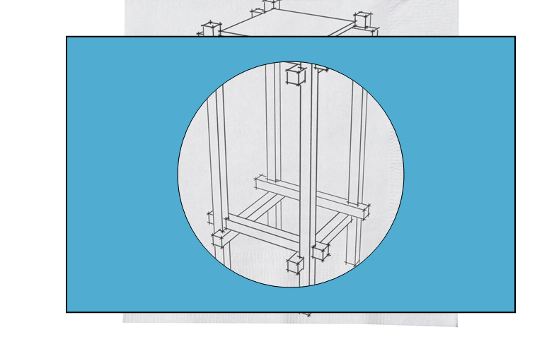

As @Anssi indicated, if that is all coming from a SketchUp viewport you could use a Clipping Mask. Maybe with stacked viewports. I don’t have a site plan I can show but here’s a quick example. Here I’ve put a rectangle with a slightly transparent white rectangle between stacked viewports (each entity is on a different layer in LO) and I used a circle as the clipping mask on the top viewport.
You could also just use a different style for each viewport and forego the transparent scrim in between.
