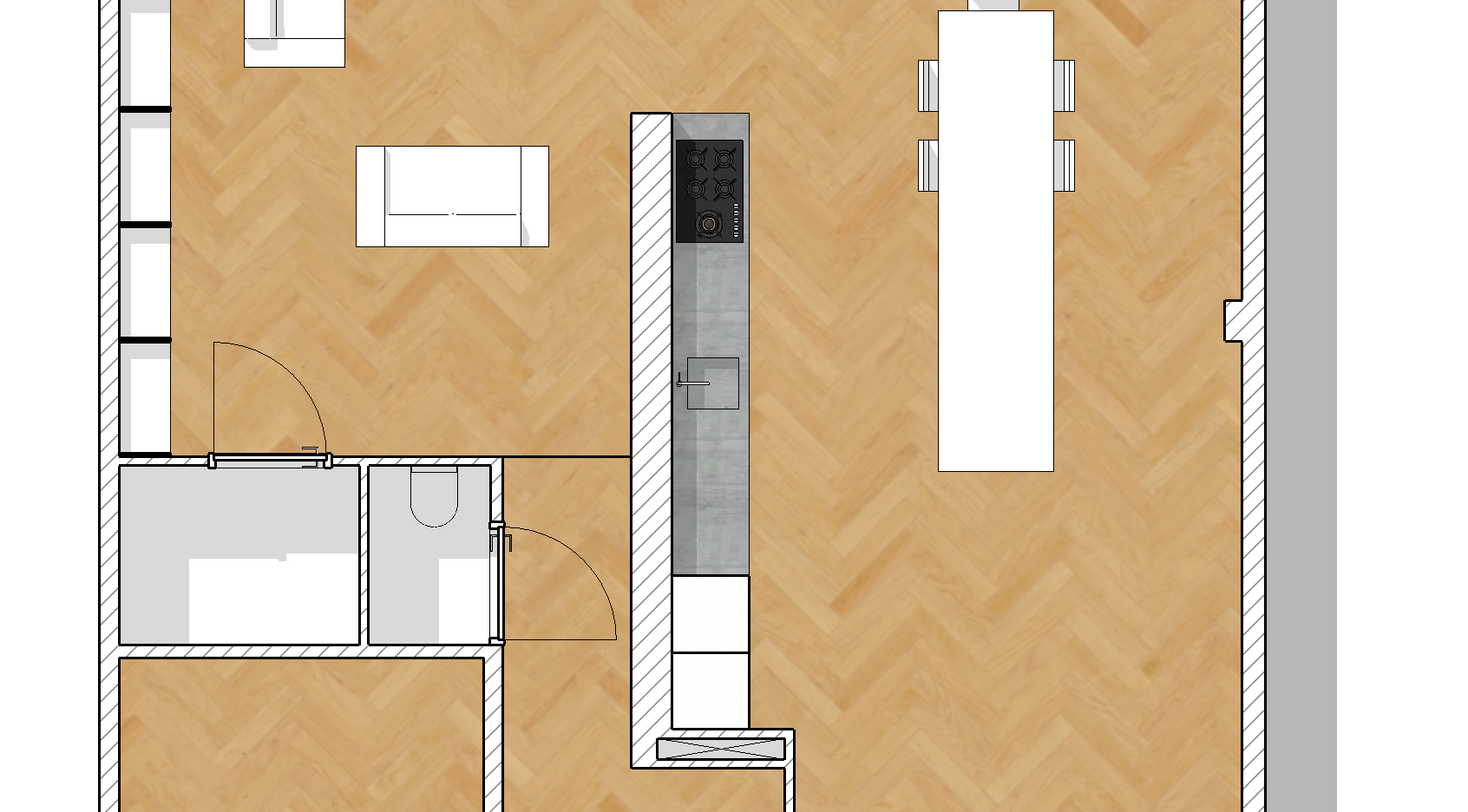

Hi,
I have 2 SU files.
The 2nd is a copy of the 1st file with some adjustments in geometry.
But in the 1st file the shadows in plan view are visible on the wooden floor of the interior.
In the 2nd file not… And I can’t find what is going wrong…
See attachments
1st file with correct shadows visible on floor, not on ground outside
2nd file with wrong shadows, also visible on ground to see if that was the problem, but it’s not
What is causing this problem?
thanks!

I solved it.
PNG files are not working with shadows, JPG files do!
thanks anyway!

Hi, I mean .png files as textures on a floor object don’t work with shadows, at least not on my Imac…
.jpg does the trick…
