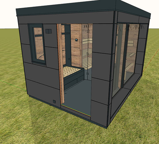

Strange shadow artifacts occuring just from a specific view:
Changing the camera slightly will eliminate these artifacts:
I tried it with SKP 2023 & 2025.
Also in 2025 with old and new render engine…and again more strange, when all objects except the bed are hidden, strange shadows:
Eliminating all objects → Shadows OK

there’s a known issue with shadows when using the “hide rest of model “ view mode
when it appears, simply toggle it once more and it’ll go back to normal.
it is a pretty annoying glitch.

The post above has it covered - seems to be a bug!
