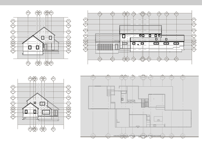

Section Planes Disappear in Parallel Projection view

That is imposable because if I take that lower right scene and twist is slightly off parallel they show up fine

like i said if i twist it lightly they show up (see the lower right of all three images)
Am i the only one experiencing this?

The Sketchup is not the problem,
Layout is the only issues or idk some kind of bugg?, check below
Experiencing this bug also. On a Mac as well. Toggling the “Ortho” radio button on/off will show the Section Planes in Ortho view but they will disappear in Parallel Projection. Double clicking on the viewport to open it will show the section planes again but as soon as you click off of the viewport and the blue active bounding box disappears, so do the Section Planes.
Quite frustrating so hopefully someone is working for a fix on this.
I have the same problem on SketchUp 24.0.594 – Windows 11 24H2 – NVIDIA 3090 TI.
The issue occurs within the SketchUp scene itself. As soon as I move or click on anything, the section activates. Even if I click a second time on the scene, the section still activates.
This made me realize that the bug is related to the Scene Transition setting, which was set to 0.50 seconds. After turning off Scene Transition, the problem disappeared.
Note that this is only in SU. I didn’t check in LO yet.
