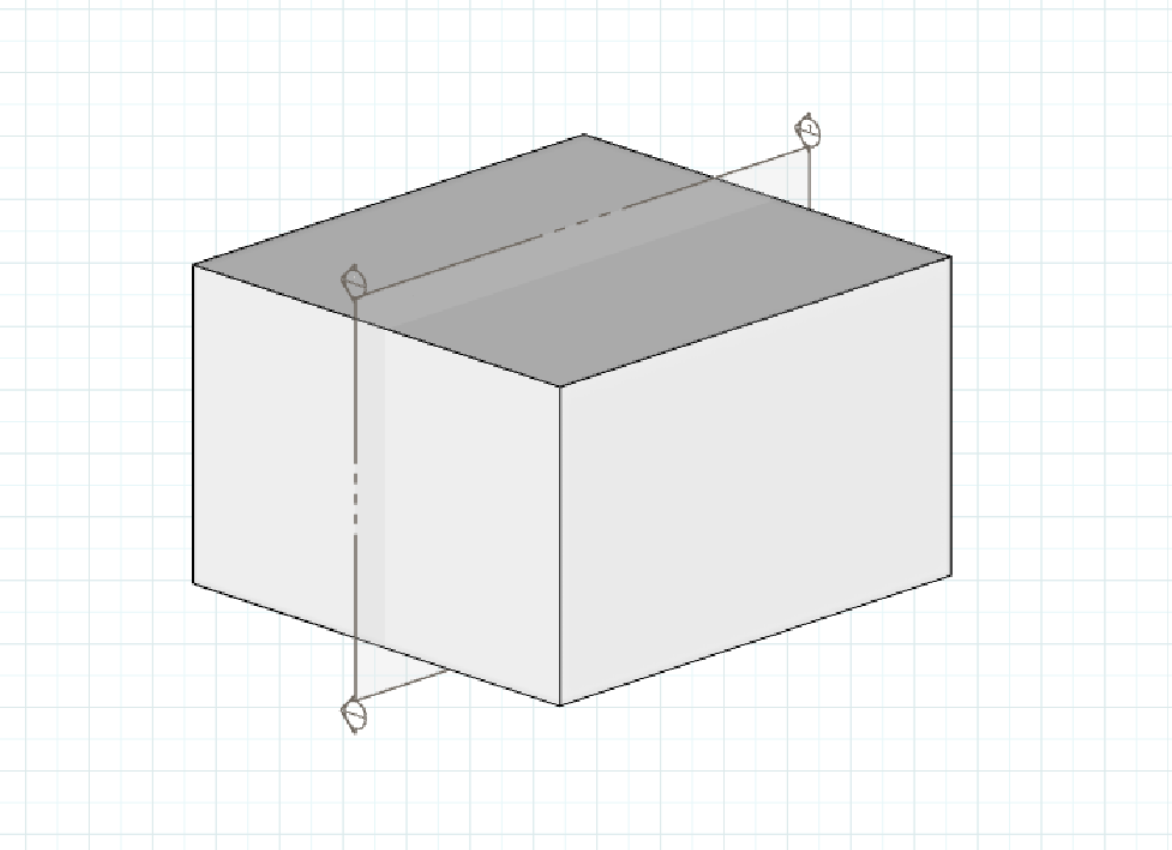

Is it possible to show section planes in Layout without having to use scrapbooks? I want section cuts off and planes on. Like this:

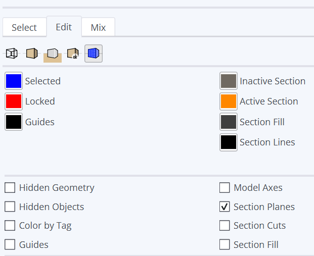

Yes, just add a scene with that particular style. Which part are you having an issue with?

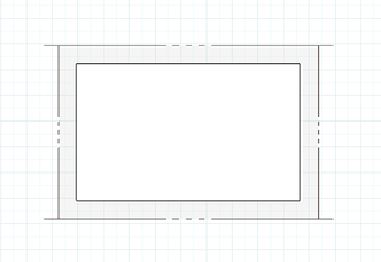

I think I remember that with an orthogonal view it didn’t work.

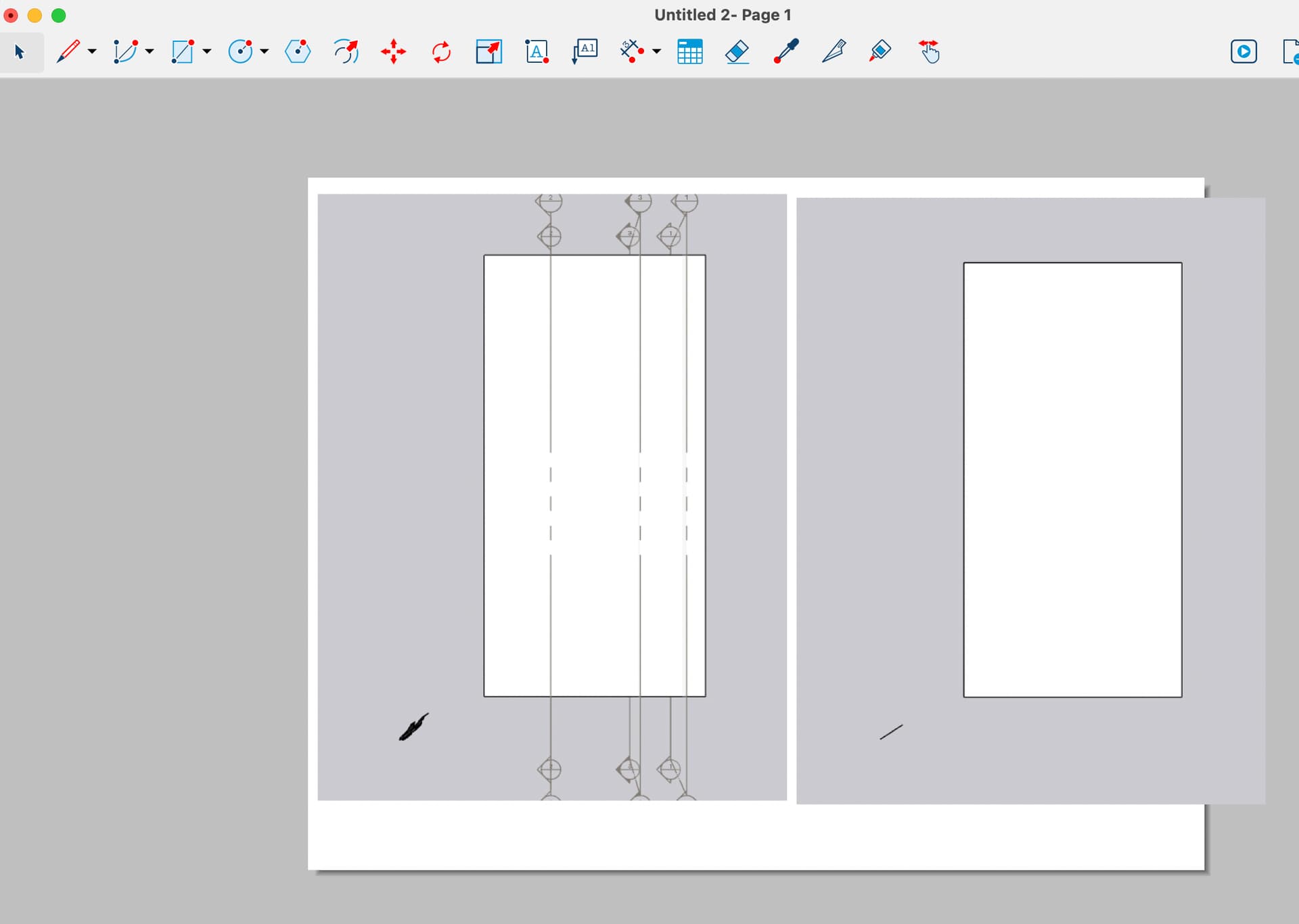

You are right, I unchecked ortho in a copy of the exact same viewport and they showed up. Is there anyway to get it to show up with parallel proj. / ortho?
My bad, which version of SketchUp are you using? I do remember it working in SU23, but I haven’t tried showing SU section planes in LO since then.

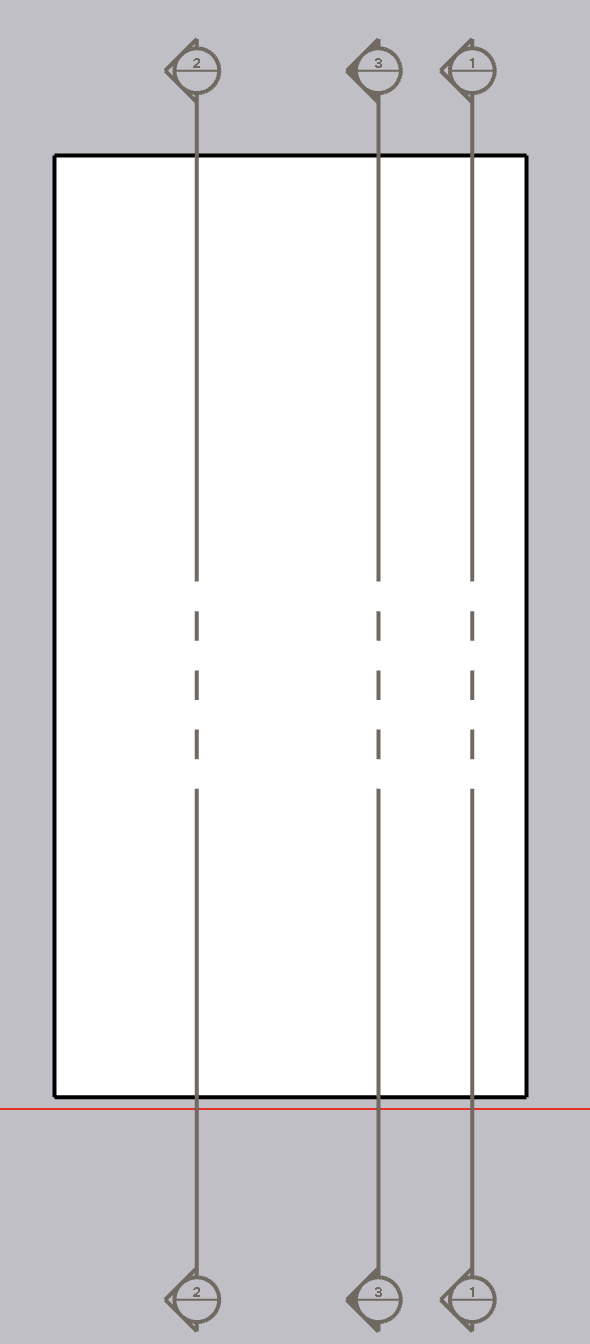

They do appear in some of the standard parallel projection views (hybrid or raster), but not when the view is looking parallel to the edge of the plane, so they are not very useful.
I’m in 2025.
I communicated it to Trimble a long time ago and they took note but from what it seems they have not solved it
