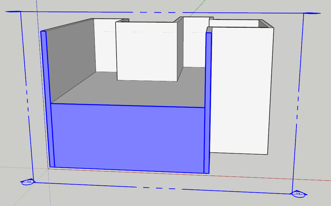

Does anyone know why the section plane isn’t cutting the first floor, as shown in the attached image?
Go to the View menu and untick section fill.
Then you can see in. My guess, without looking at your model, is that you only have one face for the floor so the bottom level is being seen as an interior void like inside a wall.
Ok that works. Thanks for your help
