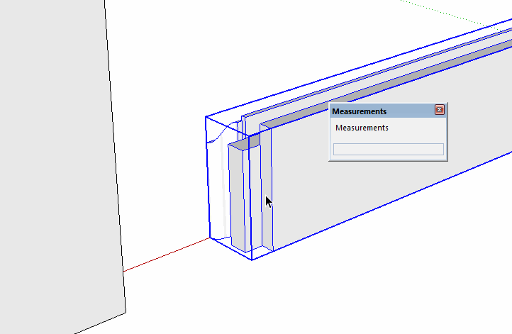

It would be useful know what it is you are really trying to do. It may be that instead of scaling, it would be appropriate to select the 45° face and use the Move tool to move it. This would be appropriate, for example, to change the length of a mitered picture frame or a crown molding. It would work in the same way as changing the length of the door rail in this screen grab.
That’s exactly what I was trying to do, your solution is perfect. Thanks!
