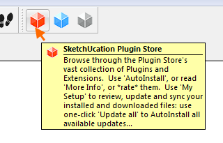

Then with the v2013 release, tooltips changed to a definition-like box with an icon, a caption, and a description:
Since then (v2013,) they have been static, and loaded only at startup.
