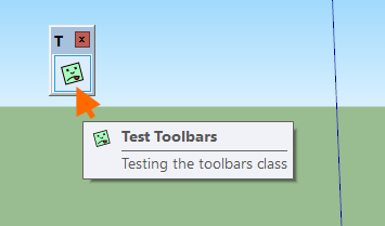

This is what your code produces on Windows 10 & SketchUp 2018 …
This is how it works since the tooltips were changed for SketchUp 2013 and higher. With that release there were new icons and the tooltip boxes became this 2 line style where the bold title is the “tooltip()” and the description is the “status_bar_text()”.
Once the UI::Command object has been added to a toolbar object, the “tooltip()” property can no longer be changed. (Prior to this in v8 and earlier we could change the tooltip “on the fly”, but no longer from v2013 and higher.)
The “status_bar_text()” property still CAN be changed at any time to reflect a tool state, etc., if you wish.
Obviously the status_bar_text() also appears on the status bar, when the mouse is hovering over the toolbar button, AND when the tool is activated. So if the button activates a Ruby Tool, and you change the status text as the tool state changes, then do not forget to reset the status_bar_text() to the default inside the tool’s deactivate() callback method.
