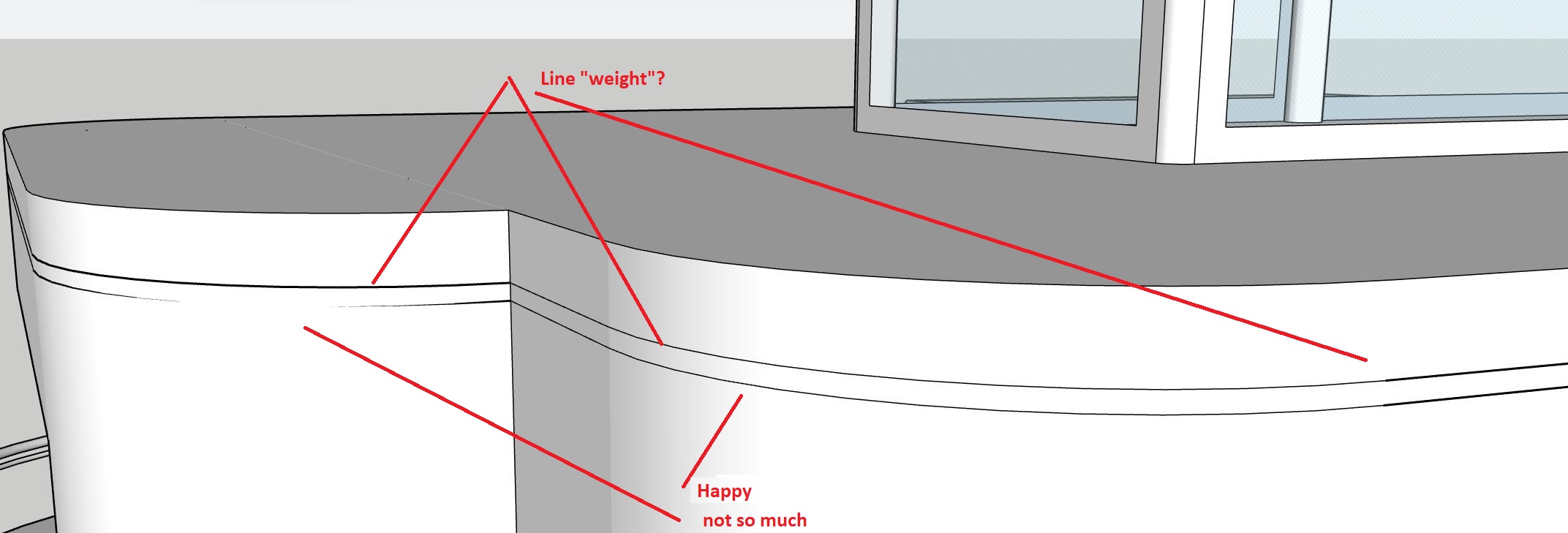

Any ideas what is going on here? Sometimes lines behave sometimes they don’t. I am super ■■■■ about my models - there is no hidden geometry in this area as far. I’ve tried intersecting and welding to no avail. No materials applied. Simple architecture view/no style.

It’s hard to tell from just a screenshot but it looks like those edges aren’t completely on the surface. If you share the .skp file with us it would be easier to help you identify and fix the issue.

I agree it looks like “those edges aren’t completely on the surface” however all of the adjacent lines/quarter circles were created at the same time and same process. It’s a very clean, simple model.

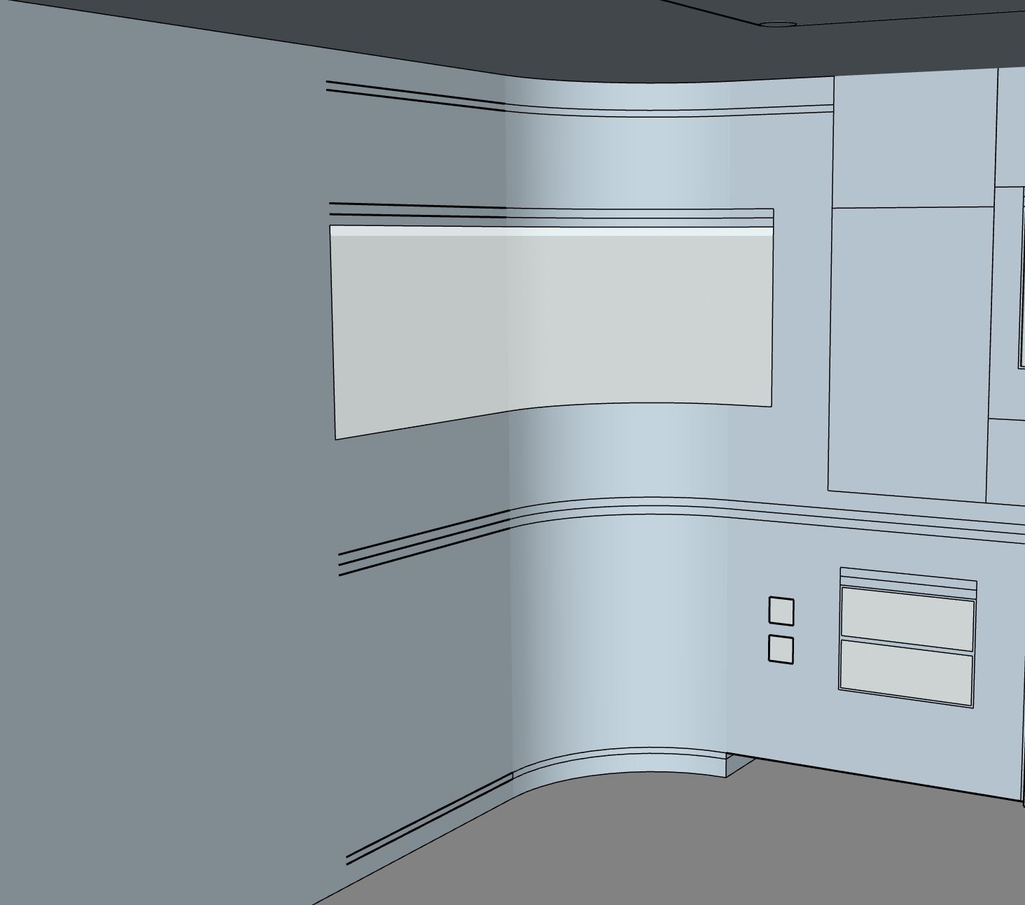

“inside” shot same area . :thinking: 30 years ago I would have just “send line to back” :rofl:

he guessed correctly. I just tried one section of your model, top left part on the image: erase the two arcs, then with the rectangle tool anchor on blue axis draw a rectangle from the beginning and end of the erased arc, finally,
select the rectangle face and the wall face and run intersect faces with selection. And arc is going to be drawn on the curved surface
