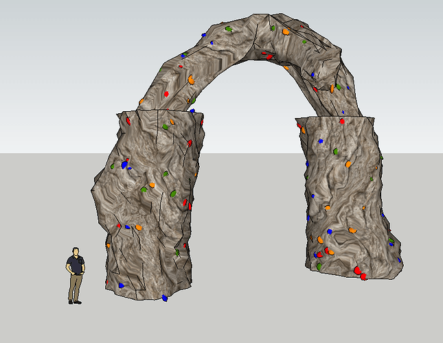

If you want to use only SketchUp, then you could go from the three bases that can be some hexagons, and drawing some path, and use Curviloft plugin to create the general structure. Then use Scale and Eneroth Fractal Terrain Eroder to get that irregular shape.
would you be able to show an example of this because I’m not exactly sure how to use Sculptris… If I make a hexagon and then use the follow me tool can I somehow warp it? I also want them to connect at one point so I am not sure how I’d do this.
Artisan subdivide
Eneroth Erode & vertex move (part of artisan organic toolset)

In SketchUp, starting from the hexagonal base and having the two paths for the shape, use the Curviloft plugin for the 3D mesh, and Eneroth Fractal Erodes for the irregular rock form.
In Sculptris, use Inflate tool for the shape, and then export as OBJ.

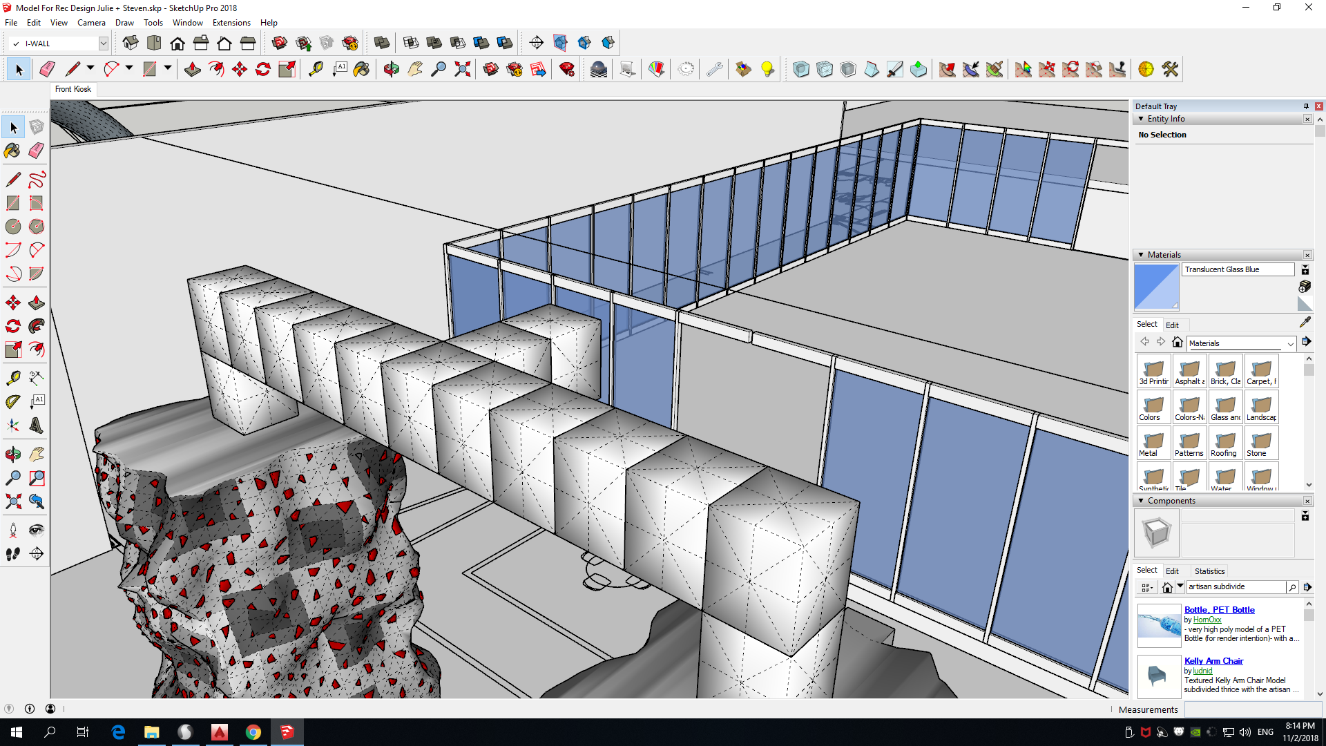

okay so here is where I’m at but where exactly did you right click to get to the erode menu? i dont see it? also to get that rocky form afterwards I would just play with the vertex move? I did cubes as Forestr explained and it was simple enough to get to this but I find its a bit tricky to get that form. In my pic its like the two connect in a straight path but I would like them to connect mid way or a little more forward. Would the vertex move be the best option for this? PS: thanks so much for all the pics and the help its really helpful! :slight_smile:

For Mac I found it in Extensions → Erode, so for Windows it’s probably in the top menus somewhere. Also, you need to download Eneroth Fractal Terrain Eroder for it to work.
56%20PM
To get the rocky form, adjusting the erode settings will help. Iterations controls the amount of polygons & pointyness controls the height of the rocky deformation. These are the settings I’d recommend. You can adjust the pointyness to your liking, but try to keep iterations as low as possible so you don’t get lag. Also, deselect the parts you don’t want to get deformed.
settings
Vertex move helps make the rock form less circular. A circular or boxy rock wall is cool, but vertex move can help you make all kinds of fun organic shapes. After clicking, you can hold an arrow key to move along the axis. To adjust the radius of vertex move, use the arrow keys or type in a value.

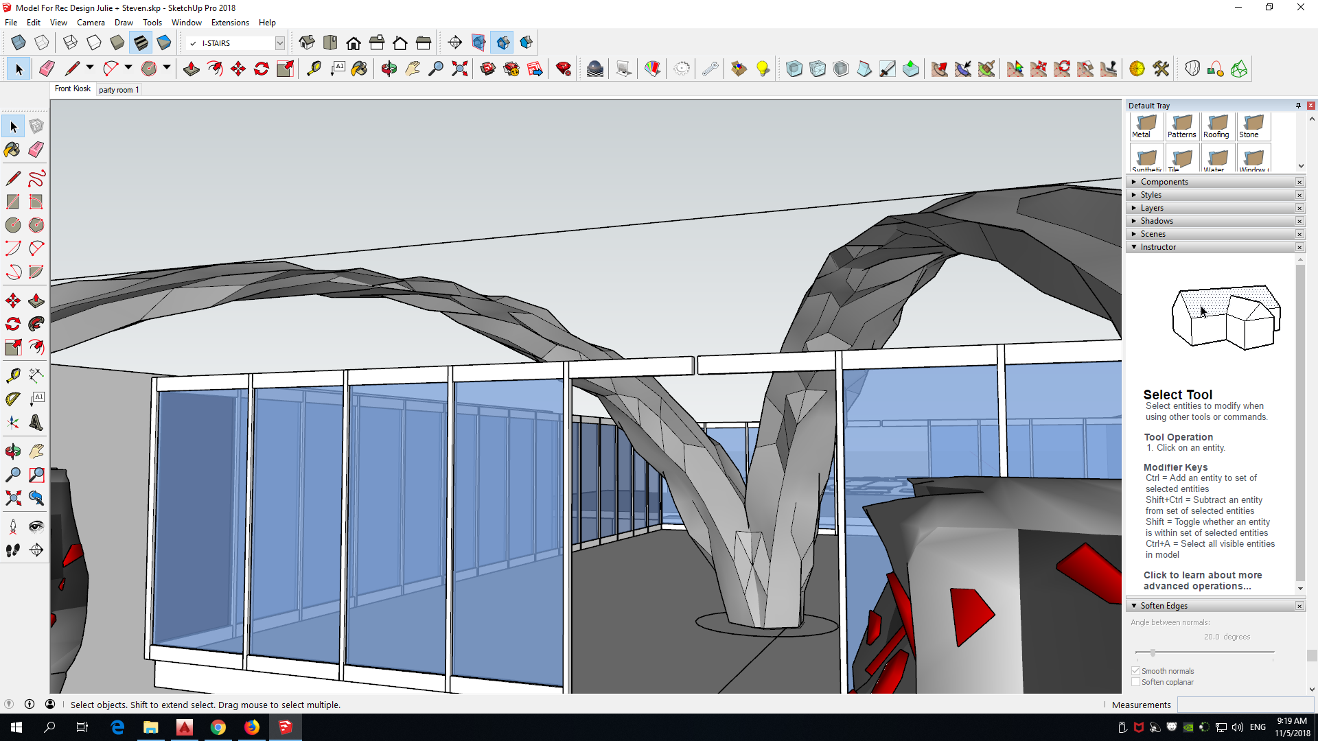

So I ended up with something like this and I tried all the extensions above and they all work well! the only thing that I’m having trouble with is the vertex move. I like the shape I have now but I would like to inflate the rock a bit more since it looks fairly thin at some point haha. Perhaps the sculpt brush will do the trick? P.S thanks so much for all the help it is very appreciated :slight_smile:
You’re welcome! I’m glad everything’s working well! The sculpt brush would work. Use tab to cycle between modes until it says inflate brush in the lower left screen. To change the strength of the brush, type “(insert distance) s”. For example, 3’s means an inflate strength of 3’. Change the radius by typing in, for example 3’. Click-drag on the mesh to inflate it. Good job! The model is really coming along great!
P.S. You might want to make a backup copy of the arches before you start sculpting it in case you want to undo.

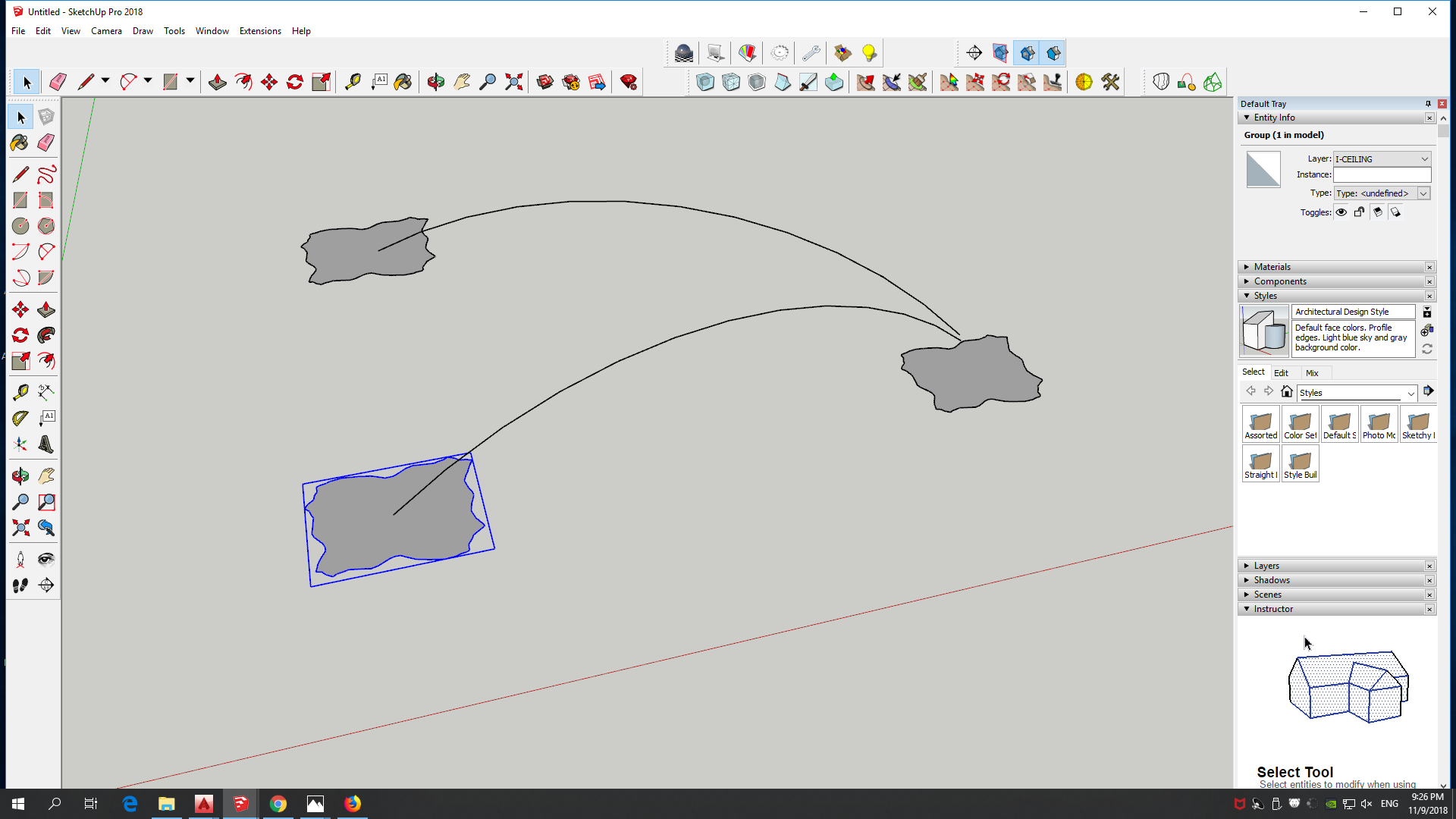

hey guys so I’m trying to curviloft a shape like this but it doesnt seem to work according to plan. Like i’d like this specific shape to arc into the other shape which is at a lower level. any way of being able to do this? i wanted to keep the same size and then with the sculpting brush I’d make it smaller.
Loft isn’t like follow me along a path. Loft creates a surface between edges. You’ll want to make a radial array of profiles, then loft will create the surface between the edges.
okay so basically I cant get this shape to arc onto the other face? what exactly do you mean by radial array? would you be able to show me an example of this? if not then my only choice would be to do the above as a hexagon and then do curviloft.

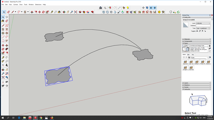

Use the middle button, Loft along path.
Loft%20along%20path

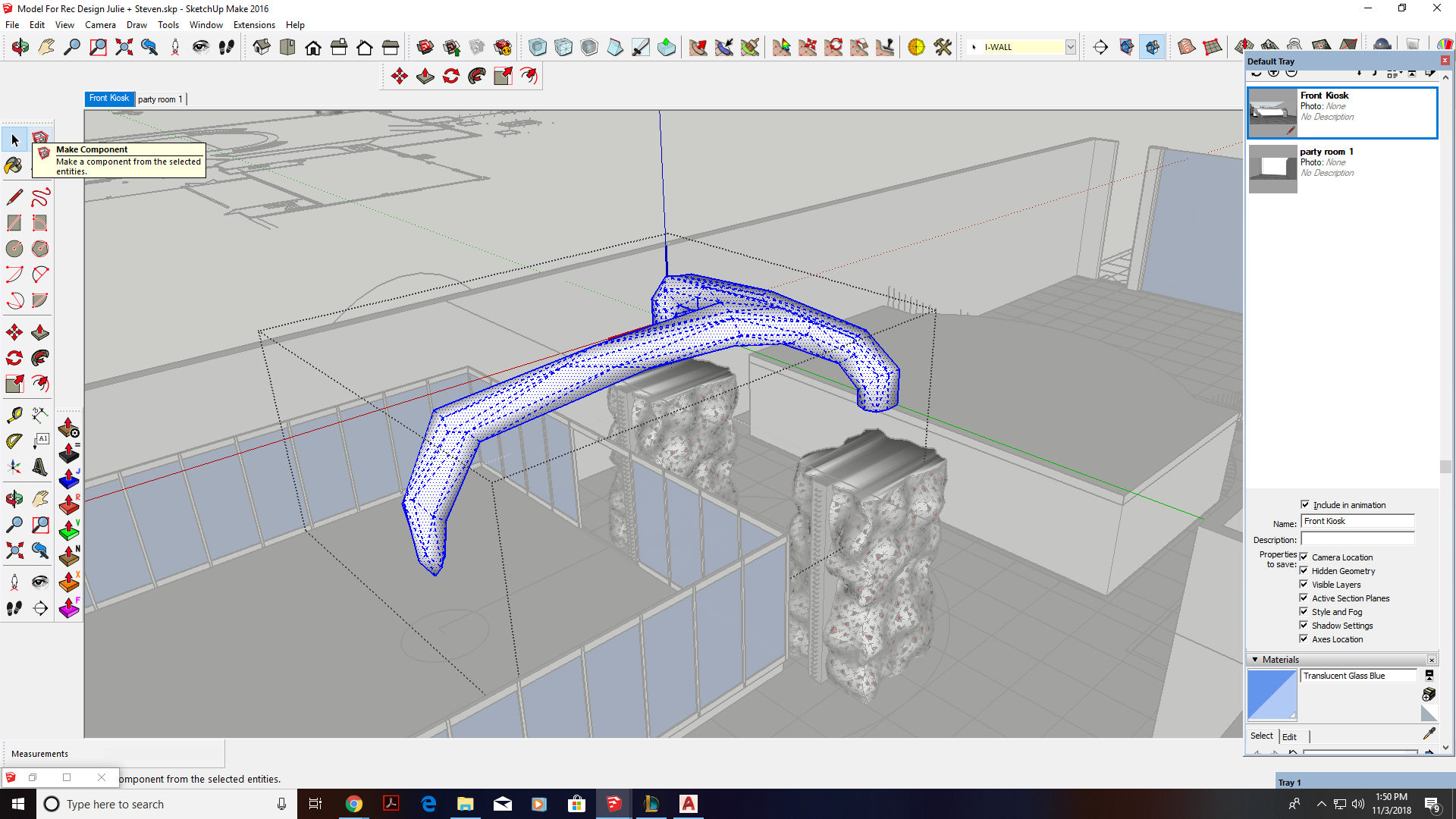

awesome it finally worked but now is a tricky part where I haven’t figured out yet so I’m trying to make it arc inside this kind of restaurant but i want it to run onto the walls so I would like it to gradually become thinner as it comes into the restaurant wall. What would be the best way to tackle this? P.S thanks for taking time to help out! :slight_smile:
Redo the curviloft, but make the 2nd profile thinner.

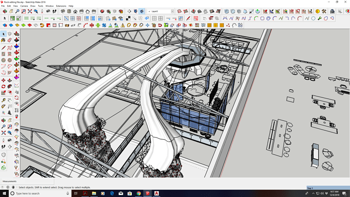

okay so Im still trying to make this rock structure and my difficulty is connecting them in the middle rather than having 2 separate arcs. I want it to look organice but somewhat similar on both sides but the thing I must respect are the steel joists and the Hexagon shape which will be above a bar area… How can I do this I’ve been trying with curviloft but you cannot select a same face twice so that it connects together and branches out like I’m showing in the pic. I tried with arc as well and the arc doesn’t switch the thickness of the rock until the last one is connected so I’m not entirely sure what would be the best solution? Any advice to making this look realistic? Also should I subdivide smooth after doing the arcs and then erode or vice versa?
