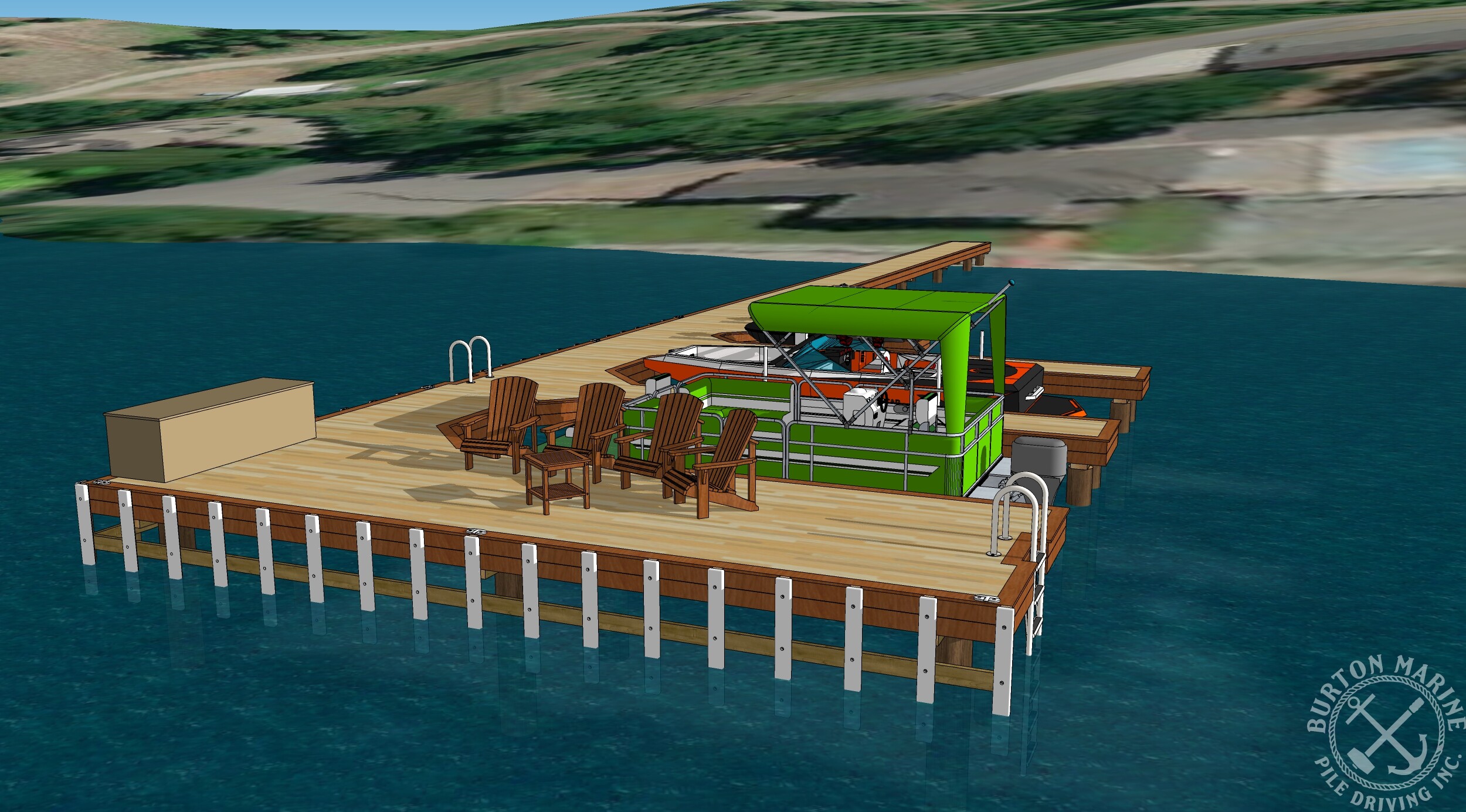

Our company builds residential docks for lakefront owners. Occasionally we will provide 3D images exported directly from Sketchup Pro. (attached)
I’m curious to know what possibilities lie ahead to improve these (always outdoor, decking focused, and “lakelife”) renders so they are more realistic and enticing for owners.
I am sure everyone has a preferred plugin, however, I’m wondering if anyone would be able to provide some sample renders of my model to illustrate the upgrade in quality for using a third party render plugin to help justify the increased costs and additional time needed to produce improved renders.
Simultaneously, I am all ears as to how to improve the 3D renders simply by utilizing Sketchup Pro tools within Sketchup that don’t appear evident in my model.
What I see in your images looks pretty nice. I might consider adding a little bit on shore but I wouldn’t add a lot of detail to it because I wouldn’t want to detract from the project itself. You could use one of the various rendering programs to give a more photographic look to your project if you want or you could go a little more toward a hand-drawn look if you prefer that sort of style. Either way, I would consider whether the added time is a worthwhile investment for the project.

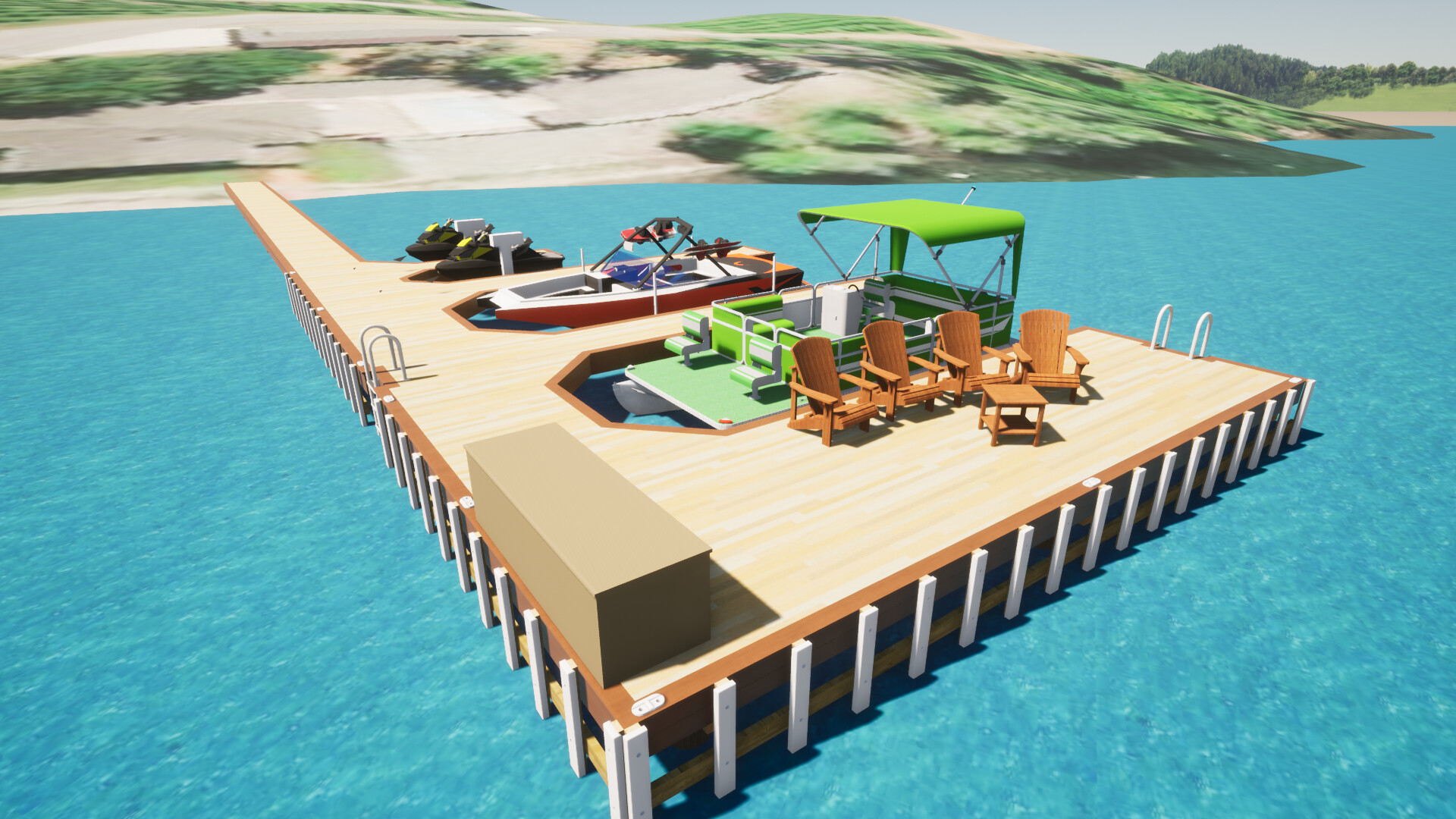

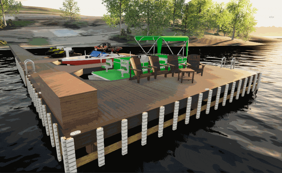

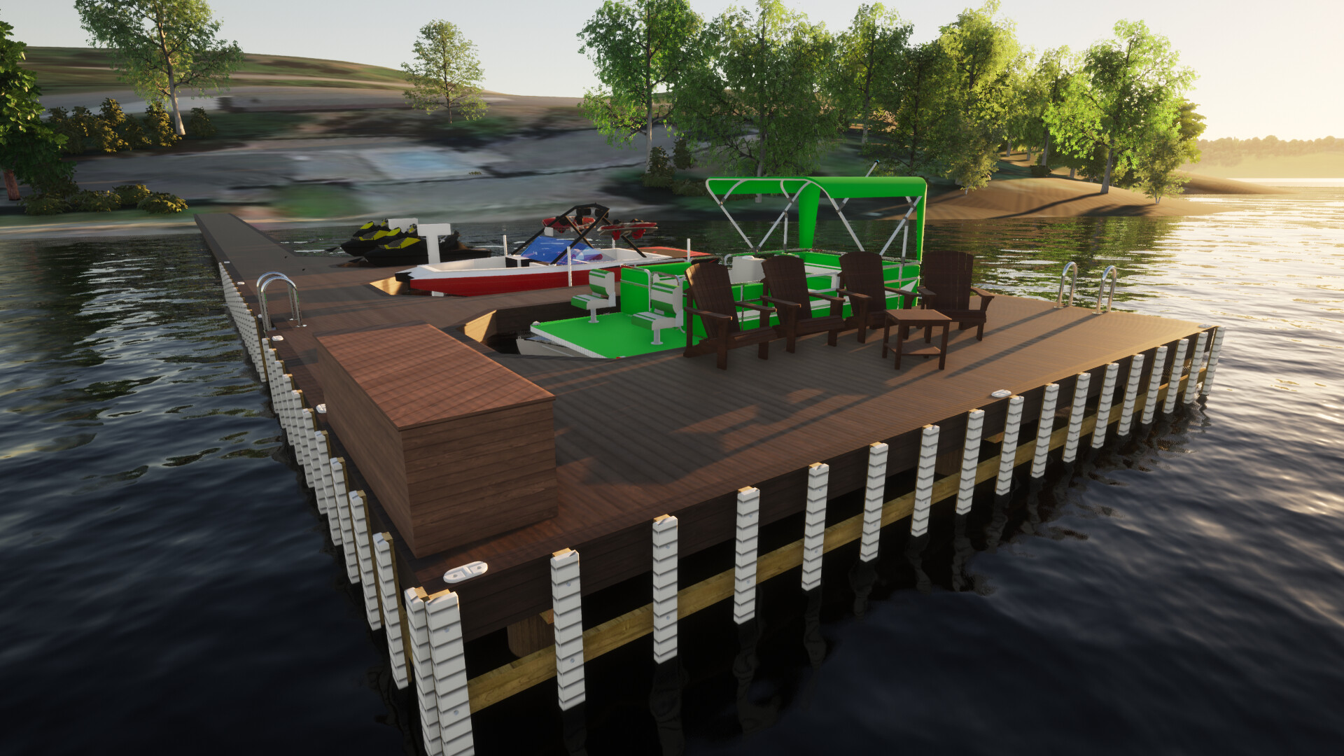

I dropped your model into Twinmotion to give you an idea. The first image is without touching it, just importing the .skp file. I then spent about 10 min replacing a few of the textures and dropping in some trees to get the second image. I only changed the time of day for the third. This could be taken much further, but it’s a starting place.
