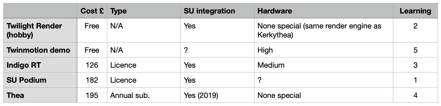

I ended up with some conclusions most easily shown by a table:
I admit the final column is not scientific as you would need an extended test of each to know. If anyone thinks they do know and would order my list differently, I’d be interested to hear. In my list 1 is easiest.
My conclusions so far are these:
Twilight may be too basic to be worth a lot of learning.
Twinmotion may be too high end in terms of learning and hardware.
Thea is the most expensive for occasional use as it has an annual subscription.
That leaves Podium and Indigo RT. Indigo is cheapest but Podium may be easier to use.
Would anyone who has more experience of actually using any of this software may like to challenge my findings?
Paul, that’s exactly the sort of discussion I was hoping to encourage. So if you wouldn’t put Twinmotion at 5, how would you order the list?
Re processing time, I was correlating hardware requirements with that. I figured that the higher the hardware requirements, the longer something would take to process on a like for like basis. Maybe that’s wrong though?
I think Twilight is very good, and has a worthwhile depth of capabilities. You can also pay for a Pro license and more features. I use Thea as well, and I think it’s been more productive for me, but I wouldn’t dis Twilight or their nice online support.
Processing time would be hard to break down in this list. For example, on my mac TM is just a toy because as soon as I turn up the quality, it barely functions. A little better machine and it’d be great, I’m sure.
I have never used the other renderers in the list, so I wouldn’t rate it 1 since perhaps some are really easy to use too, but definitely no more than 2 on a scale of 5 !
I believe it is a wrong way of thinking !
For example twinmotion will take max 1 min to make a full HD render, even with a very cheap computer.
It does require a good hardware to be in good quality preview, but that is another matter !

TwinMotion seemed pretty easy compared to others to get going in and the real time response is very helpful. It then takes more learning to get get to quality renders, but it doesn’t seem to be the most difficult “5”.
In terms of ease of use I would say Twinmotion is as easy as you can get.
Thea varies: if you want to hit the button and render like in your initial description (in the other thread) it’s easier than Twinmotion. If you want to reach photo quality you need to learn oh so much. When you do, you can fake reality. You can do that with Vray and Indigo too.
I can’t compare Thea with Indigo as I never tried Indigo. Thea is easier to grasp than Vray. Indigo should be too as both Thea and Indigo are Unbiased renderers: they don’t need render settings to be tinkered and light will be calculated as in real life. Vray has one of it’s engines working like that but it’s lower quality than Thea’s in my honest opinion.
