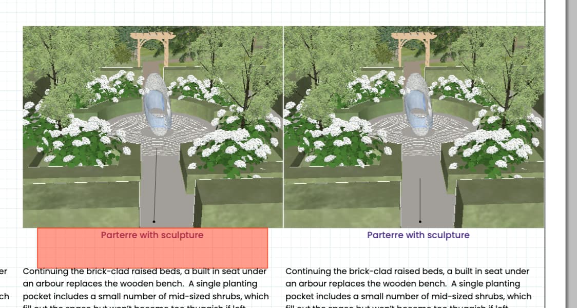

I have a viewport to a model with an autotext label to the scene. The others in the document are behaving as I’d expect, but I have one which is showing red. I’ve relinked the model and refreshed, but no idea how to fix it. Any suggestions please?
Right click on the text and select reconnect with the model.
I’ve already tried that to no avail
If you don’t want to turn off Warning Symbols for Disconnected Annotations then you could try selecting the label then Cut then Paste – that would then disconnect it from the viewport.
You may need to upload your file to look at to get an exact answer.
It’s noteworthy that the red “broken reference” warning does not print or export. So if the text is correct you can ignore it.
