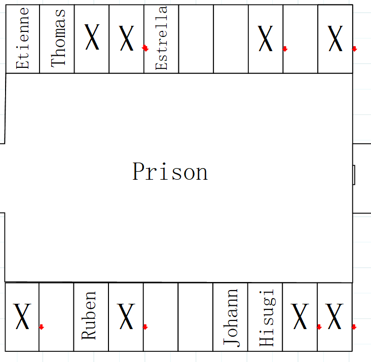

Hi! I was curious what exactly these arrows mean and how do I get rid of them? thanks.
it means your text is bigger than the textbox.
in your case, it looks like the bottom of the X is missing. you can either pick a smaller font size, or a smaller font, or make the textbox bigger
or leave it, since it won’t show on the final pdf

This happens often when I exchange files with clients. I’m on a Mac, most of my clients are on PC. Even with same or similar names fonts they see a lot of these - something off with the text box and font sizes.
Fonts differ from Mac to PC, so the app will swap in a font that’s close to the same style.
  1. If it’s just one or two, select it and right click “Size to Fit”.
  2. If you have a lot of text, put it on one layer, right click on that layer in the layer inspector, and click “Select Entities”, the mouse over one of the selected text boxes, then right click and “Size to Fit” and they’ll all be updated.
