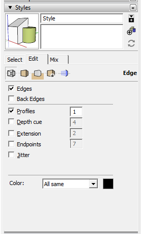

This is not a pro-only feature. Look in the Styles window. Set it to In Model by clicking on the house. Then the Edit tab. clicking the various cube icons below the row of tabs will get you to various categories of settings.

The Edit tab is shown in the image that Dave posted above. It is a tab of the Styles inspector panel. (It has sub-panels accessed via the row of 5 icons.)
